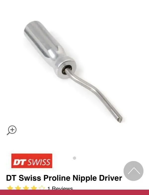

One luxury tool I guess is a nipple driver, I’ve got a Bicycle Research one which is pretty much the same as this DTswiss one. Great for that first bit of threading. Only got this as it was in a job lot of stuff, don’t think I’d pay the price for a new one!
