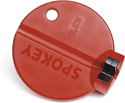

A flat head screwdriver and a good nipple wrench is you all need to get started !

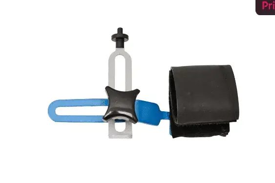

cheap jig is fine, they are a bit flimsy but I've built 10-15 wheels on one in the past few years without issue (my previous jig died in a freak accident). you can make them a bit less flimsy easily enough. I bolted mine to a steel plate (I had it from something else) and used my dial test indicator and mag base last time because I could, it was nice but not really needed.

decent spoke wrenchs, there is no substitute for these, once you've rounded of a few nipples you soon figure out why. I have 2 types, the park style loop one and a couple of old cyclo ones that are really deep for fine torquing of nipples.

set of forks will get you going at least and don't cost anything if you already have them.

You reckon I should go for a cheap jig or just use my old steel forks that I don't need anymore? Was thinking to fasten them into a hole in a solid thick wooden board to stop any kind of movement, then put one of these on the forks:
