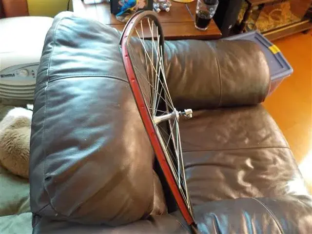

Wheel building is very complicated, or not. My son made a rim heart shaped so I did the unthinkable and moved the spokes over to a new rim one by one. The LBS said it was a very bad idea, but those kids didn't ride bikes with rim brakes, when we had to do this regularly. He's treated the wheel with no respect subsequently, but it's all OK so far.
Nah, it's not complicated, just careful...
Usually, a bent rim's hub and spokes are fine. I folded my road bike wheel last week *sigh*, but was able to transfer to a new rim with no particular difficulty....
Took an hour.
