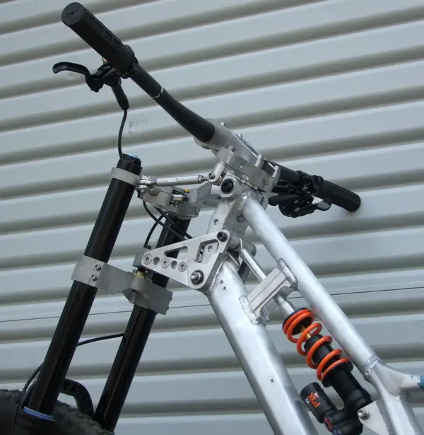

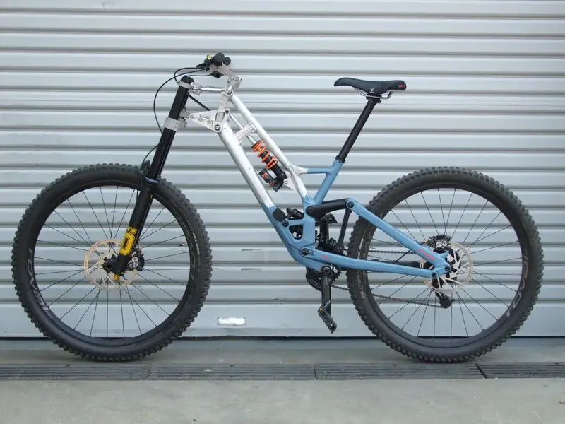

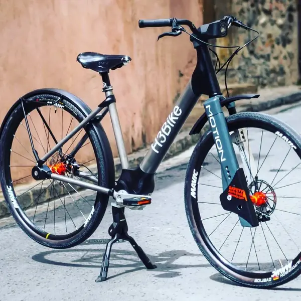

Nothin’ new in t’ world - linkage forks...
just right for an e-bike - heavy, massive spec, etc etc. Makes the breed even less like a mountain bike....

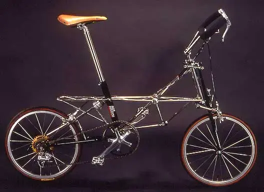

It seems part of a town/utility bike thing, with shaft drive.
A project around a 100% French-built bike, apparently (pity about the Brooks saddle and Magura brakes, then.😊)

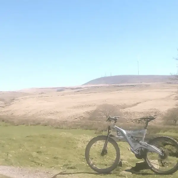

What a delicious thread! My small collection of 5 bikes includes 3 with linkages. I built a tribute to the Girvin for my Proflex Attack LE which came with an RS Quadra 5. 1625409506391.webp 1625409506391.webp
