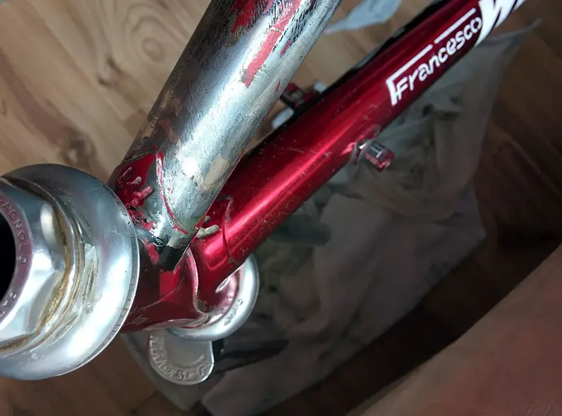

I've did some filing the other day to get the brazing flush with the tube and in the process found out why it's there. The top tube cracked, looks like all around. Not sure but think it might have been dented (the larger remaining piece of brazing) and that caused it.
Anyway we were thinking about what to do, risk riding it or get it replaced and repainted when I had an offer of a new Cinelli Supercorsa in laser blue for a good price, so will use the Moser as a cheap donor bike. Will sell the frame sometime for whatever I can get for it. The Cinelli's not old but they're fairly timeless and look really nice!

So it's confirmed it's not safe?
Real shame as this is a very nice Cromovelato with the "Testa Piatta" fork crown!
No it hasn't been but the Cinelli frame was so cheap it made sense to get it. Having said that I've not seen anyone say that a braze has enough strength to hold a crack together, unless it's a nice chunk like you'd get at a tube joint. Extremely unlikely the whole front would just drop off though.
Even bought some metallic vinyl wrap that was a close match and only a few pounds rather than a few hundred for a rechrome and paint.
