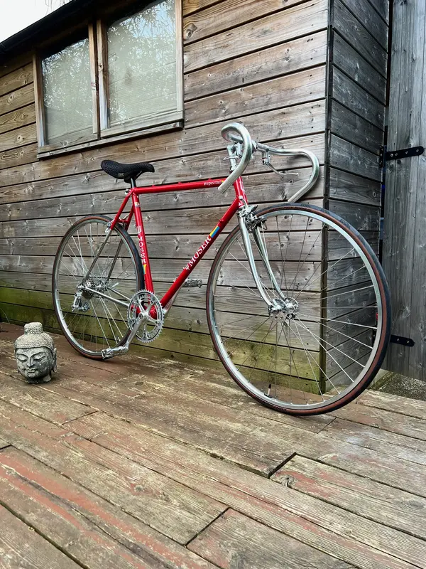

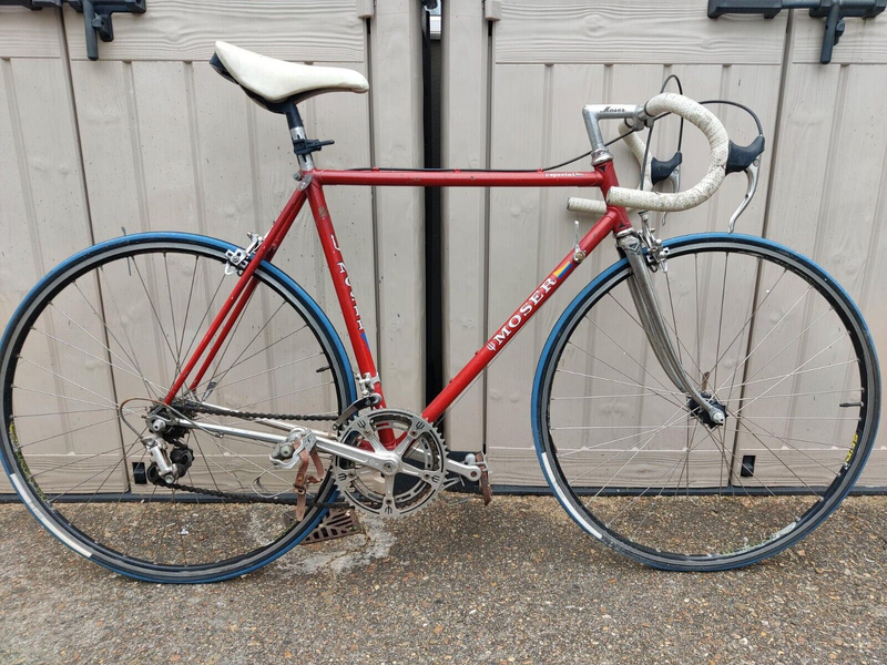

So, I'm not often found around these parts... my cycling history has been BMX and Mountain bikes for the last 40 years:oops: I love restoring classic Mountain bikes....BUT I was strangely attracted to this rather sad looking road bike s-l1600.jpeg and so I bought it. The reasons were perhaps not the best, I'll be honest, I thought it was an early Fransecso Moser (turned out it is not!) It was actually built by Moser Cicli, who still have a shop in Trento, Italy.
When I finally got it, it was clear that it was in need of a complete restoration. Whilst many of the Pantographed parts were not in bad condition, rust had got into the frame and the paint actually rubbed off on your hands. Whilst you can't really see this in the original photo, it needed some attention

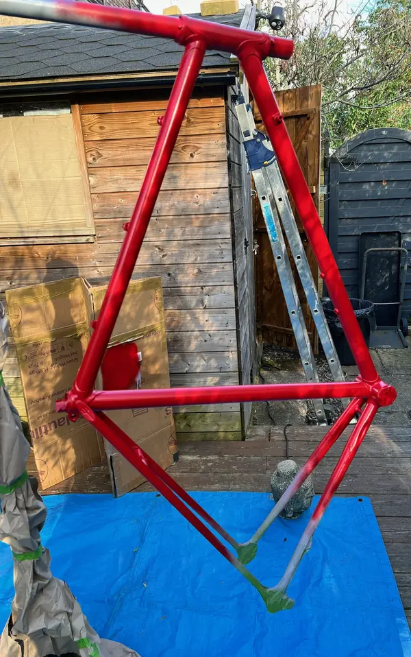

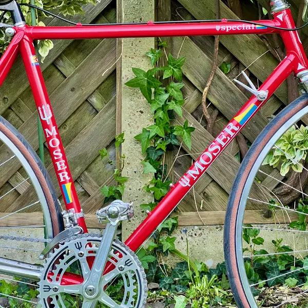

So I stripped the bike and repainted - 3 coats of primer, 3 coats of red, some Spray.bike kierin flake (for a bit of sparkle) and then 3 coats of SprayMax 2k Clearcoat.
I managed to secure some replica decals from a company in the Netherlands (https://www.unlimitedwebshop.nl/) and applied those (before the clear coat obvs ;-))

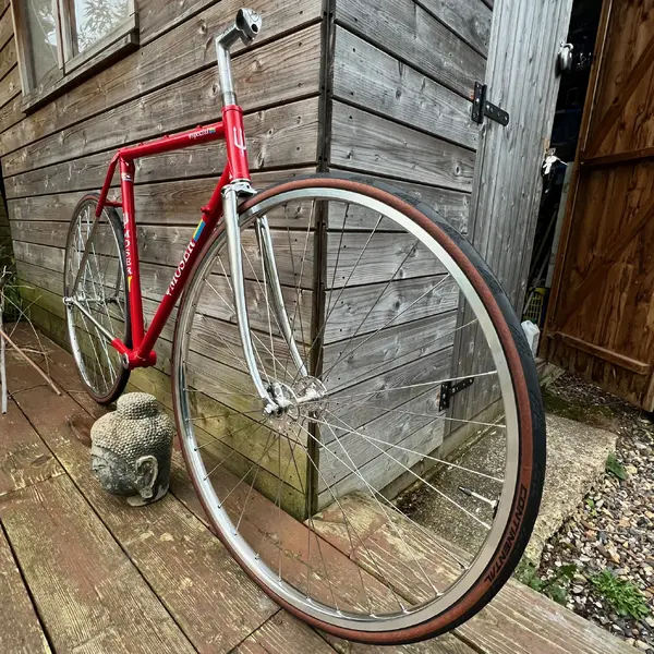

I painted in the heart shaped details on the lugs by hand. It came with an old Mavic Wheelset which were shagged (technical term). I fancied making it quite blingy so I bought some chrome rims from Brick Lane Bikes and laced them to some large flange Campagnolo Nouvo Tipo hubs ( I'm a sucker for a large flange).
Meanwhile I cleaned and polished up the aluminium parts and restored all the components with Autosol and Mothers. The pantograph elements were repainted using a black acrylic paint pen. Everything was stripped down, cleaned up, re-greased and reassembled.

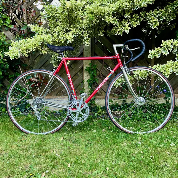

Once the clear coat had hardened, it was time to put it back together: The old Iscaselle Saddle was not to my taste so I replaced with a Concors Saddle.
Bar tape added and Dia-Compe Guidonnet Brake Levers ( I don't like traditional drop bar brakes, but that' s another story)
and then I left it for 6 weeks. partly because I had other projects but mainly because I wanted the clear coat to properly cure.
I took it out for a proper test ride this evening. It is awesome. very smooth and fast. there are a definitely a couple of things I need to fine tune :).
I hope you think I have done this old Moser justice in it's restoration. I'm not sure whether it is 100% accurate in its build and to be honest I don't care too much, I've used a bit of artistic licence :)

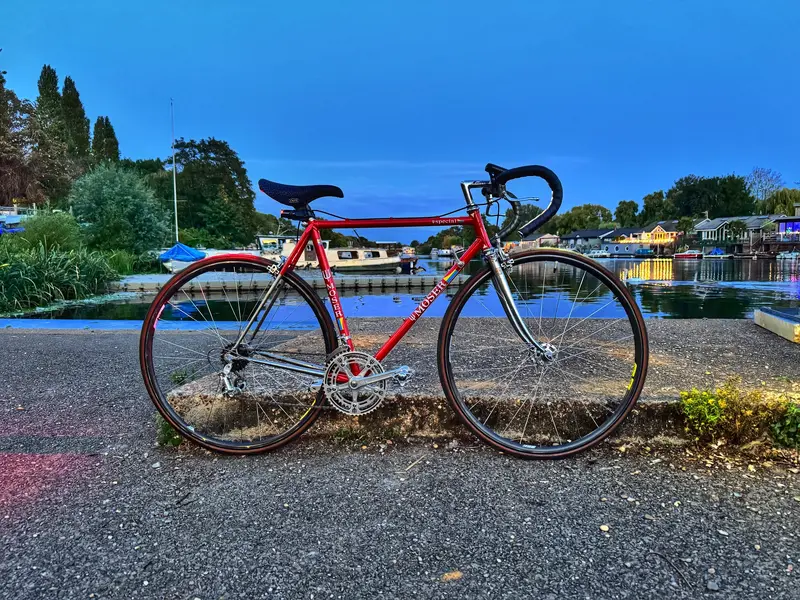

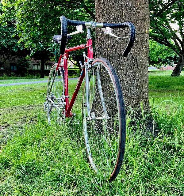

Bit of an update on this one, over a year since I renovated it and it - unusually (because I ride all my restos) it hadn't really been ridden. I didn't enjoy how it rode and rather than trying different options, I just stashed it and moved on with other projects....over the summer, I had it in my mind to move it on, but a combination of being extremely introverted, busy at work and still oddly attached to the old thing meant it was carefully stored at the back of the shed.
I got it out to steal the original wheels I built for it for another build and popped these on to enable it to be stored easily..
I thought I should try it again before moving it on and I'm glad I did. The ride quality is so different, much much better! (and the wheels I took off are great on the bike they went on). It's taught me that even if there is nothing wrong individually with components, sometimes they just don't feel right in combination...
So it is staying... and my plan to reduce the collection a little is scuppered, but in a good way!
Amusingly, when I bought it, I thought it was a Francesco Moser, but of course it is not. It's actually a Moser Cicli as Jim suggested. Interestingly there are far fewer of these about (not that it really matters, but it makes it a bit more unusual I guess).
Also the wheel swap meant I could take off the derailleur extender, which I did when I got home.
