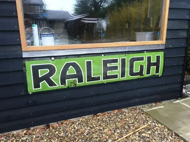

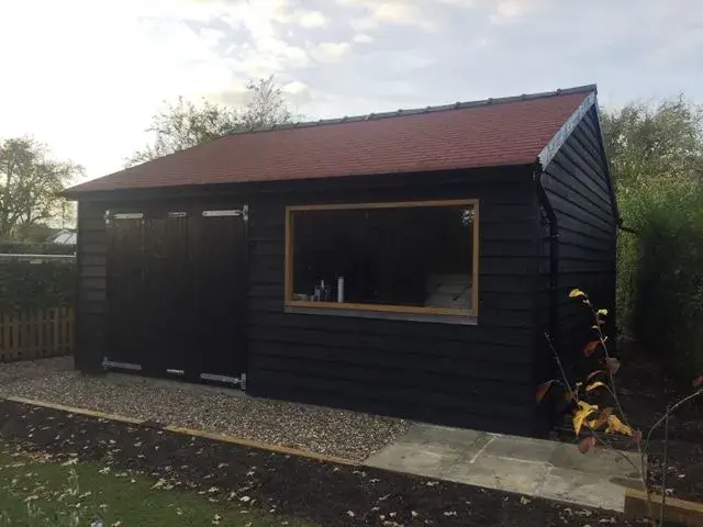

supurb! i like the stage buy stage of the build, i built mine last year and its still not done after an accident. hopefully mine will get finished, it water tight for now.
i only took 3 pics.

Excellent work, well done. How much has this cost up to now ?
ermmm, its cost about 9k so far.
the planning permission was about 240
slab came in around 1500 inc the belolw.
digger & dumper for 1 week came at 160 = diesel.
there is 40 sq meters at 8 inch thick concrete. 468
rebar was free from local farmer.
we had to remove 44 tones of topsoil to get it level. so grab lorries were needed.
26 x 8x4 sheets of 50mm insulation board. 900 ish.
i snapped my ankle at the start so a chippy for 2 weeks came in 2k ish, then the rest was materials,
i was quoted 35 - 40k from local builders which i didnt have so its taken about 18months now chipping away at it.
electric will be nothing as im a sparks by trade. just some cable etc.
ive got exact numbers somewhere.

Looks like a great space, what is it intended for ?
