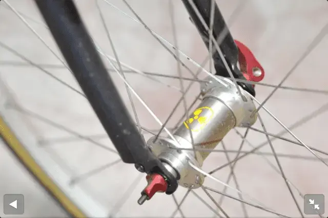

The alluminum used for the flange is quite soft. So, you may not tighten the spokes a lot.
It's the same alloy for TNT or Nuke proof hubs.
On mine, there's a shimano body, but impossible to tighten or to adjust the bearings in it (until I glue them…)
The wheelset in question I'm looking at has these hubs. So are these prone to crack???
Don't want a garage queen wheelset. The bike will only see light duty, but I don't want to be constantly worrying and checking my wheelset for cracks and it failing on me. :(

My carbon/allow front hub broke at the outer flange. Looking at the construction it's no wonder, there must be less than 1mm of material between the inside bearing bore and the spoke flanges.
Rear hub suffered a crack on the inside, allow sleeve cracked outward to the spoke flange.
I can post pics if anybody is interested.

Don't want a garage queen wheelset. (
in which case I wouldnt ride them. theres not a few isolated cases of these hubs failing, theres a lot. I had 2 rear hubs fail, the alu flange cracking on 1 hub & the alu flange seperating from the carbon central section on another. for actual riding i'd be more inclined to recommend hugi, phil wood, or shimano
