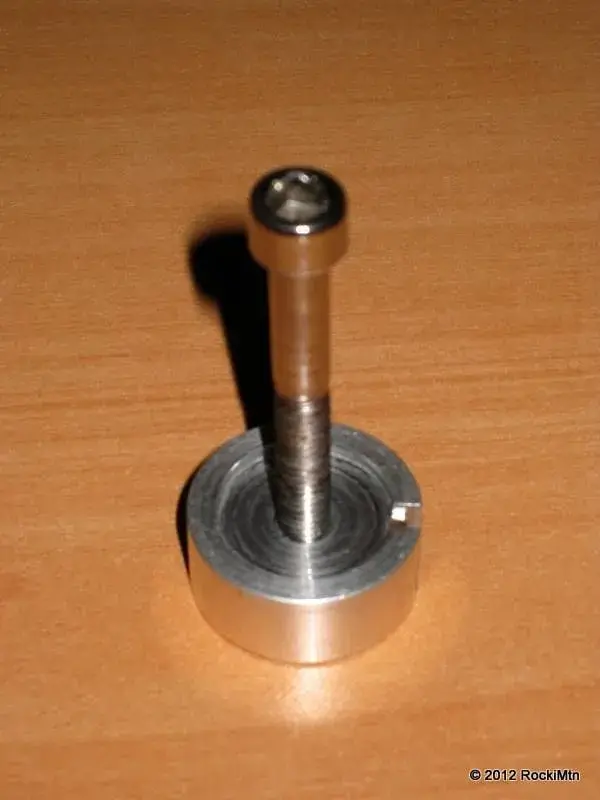

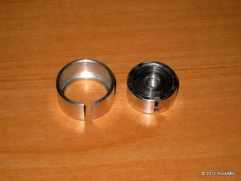

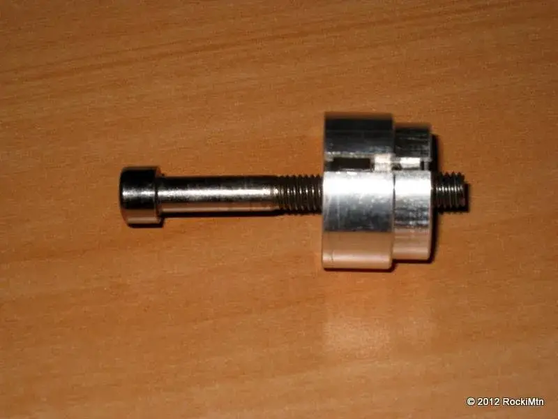

so it seems i've come into possession of one of these, or at least parts of one. wonder if the original OP or anyone else has any more info.
