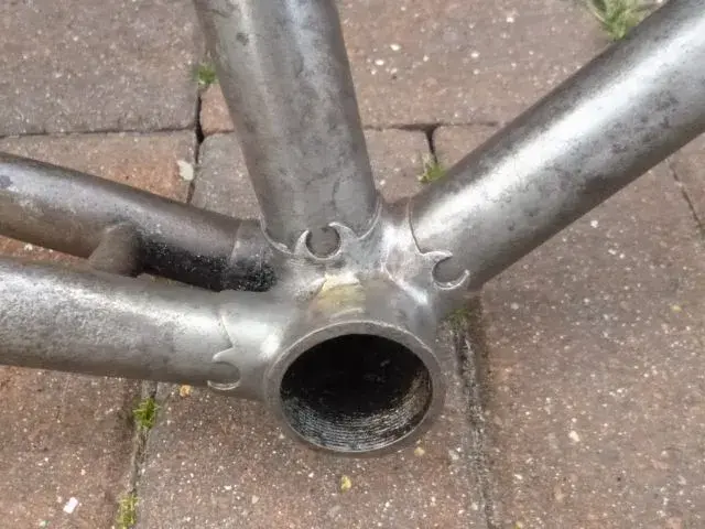

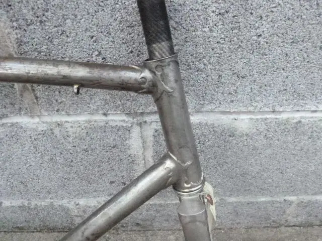

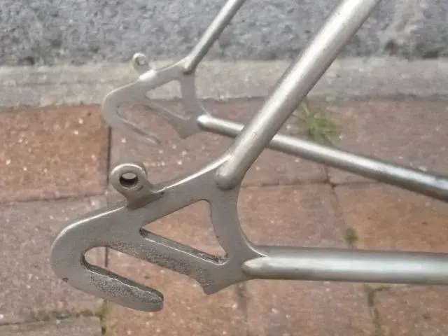

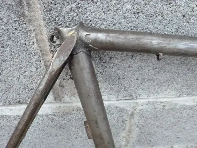

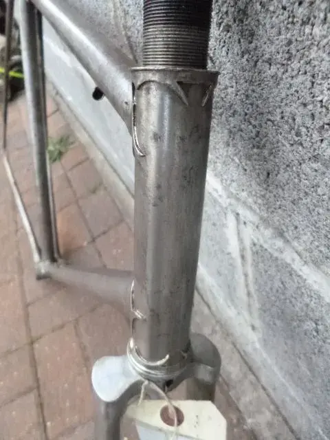

Mystery Lightweight Frame Find Today 50s??,Anyone Help
Here are some photos of the stripped frame
A bit of work still to be done to clean it all
Then wet or dry treatment
A friend of mine is a motor vehicle sprayer,he says it will take laquer on the steel
But would have to add etched primer for the painted bits.

If it were my frame and I wanted to keep the bare metal look I would have it soda blasted then primed and lacquered
Don't get it sand blasted as that is too course
I don't quite follow what you mean by priming and then laquer.
I thought primer came in different colours????
I would love to get the bare metal look polished and clear lacquered.
Sorry for being a pain.
Malc
PS what's astonishing is the weight is so light
You can not lacquer on top of bare metal the lacquer won't bond to the tubes, you need to use some sort of primer. If you have a local car paint shop go in and speak with them and they will be able to advise what products are available in your area.
Try this link for details
This frame has to be about mid 50s. If the numbers you refer to are under the bottom bracket they are Nervex identity, not frame.
I nearly made a comment about the forks being later, but reread the thread, and had forgotten about the Pennine CO2 pump braze on.

Rear ends being pressed would tend to suggest earlier, as forged ends almost replaced them by 1960.
I have a Ephgrave frame from I believe "1951" that has identical rear pressed ends and I mean "identical" could have been twins separated at birth ;) not sure if that helps much with dating but thought it worth throwing into the pot ;)
Mick
For what it's worth, Jack Taylor's had their serial numbers on LH rear dropouts, but number 290 would maybe be too early? Possibly pre-war even?
