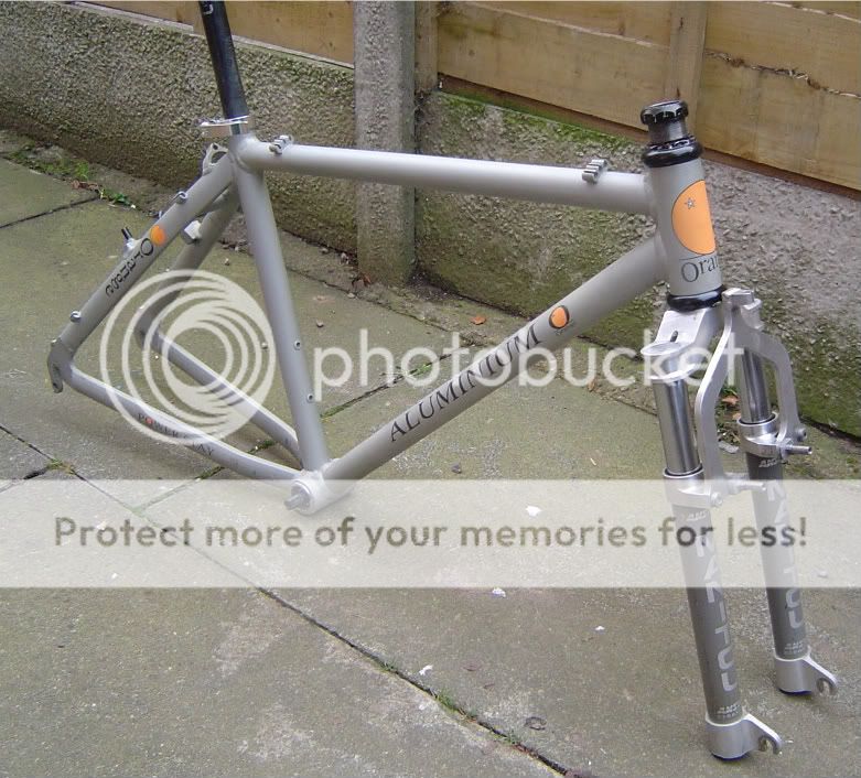

My Orange Aluminium O - the inch and a quarter dilemma.
My AluO is also a 3rd batch frame - and has a USE post & shim.
I can check the sizes in the morning.
Can you age and ID it??

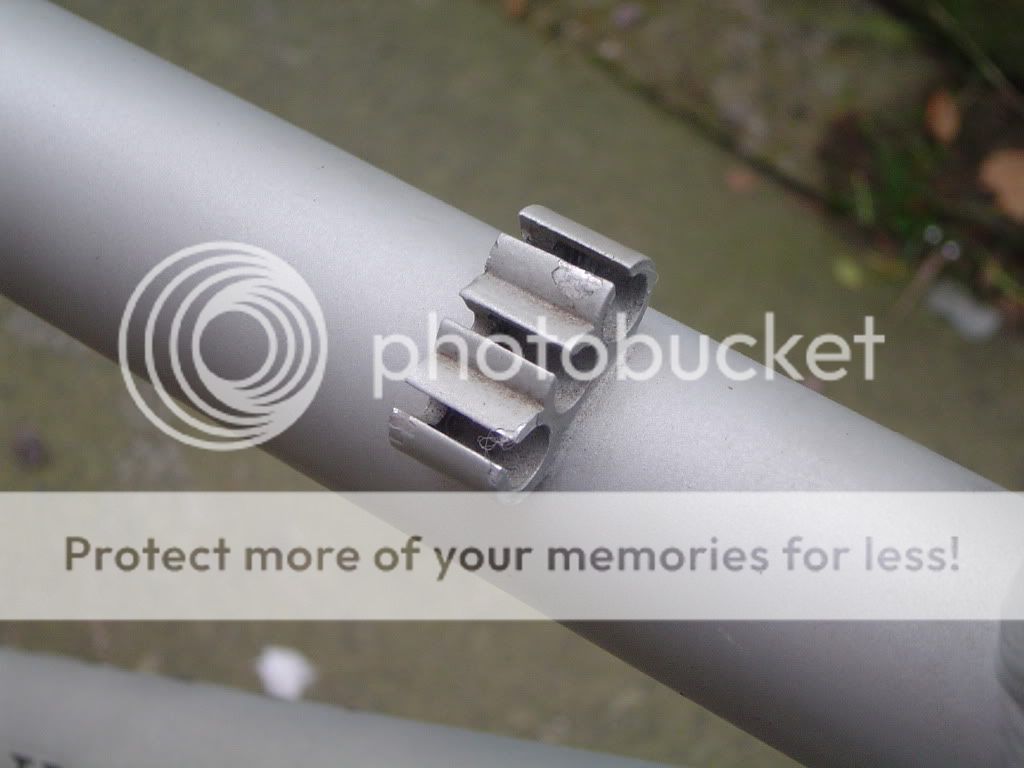

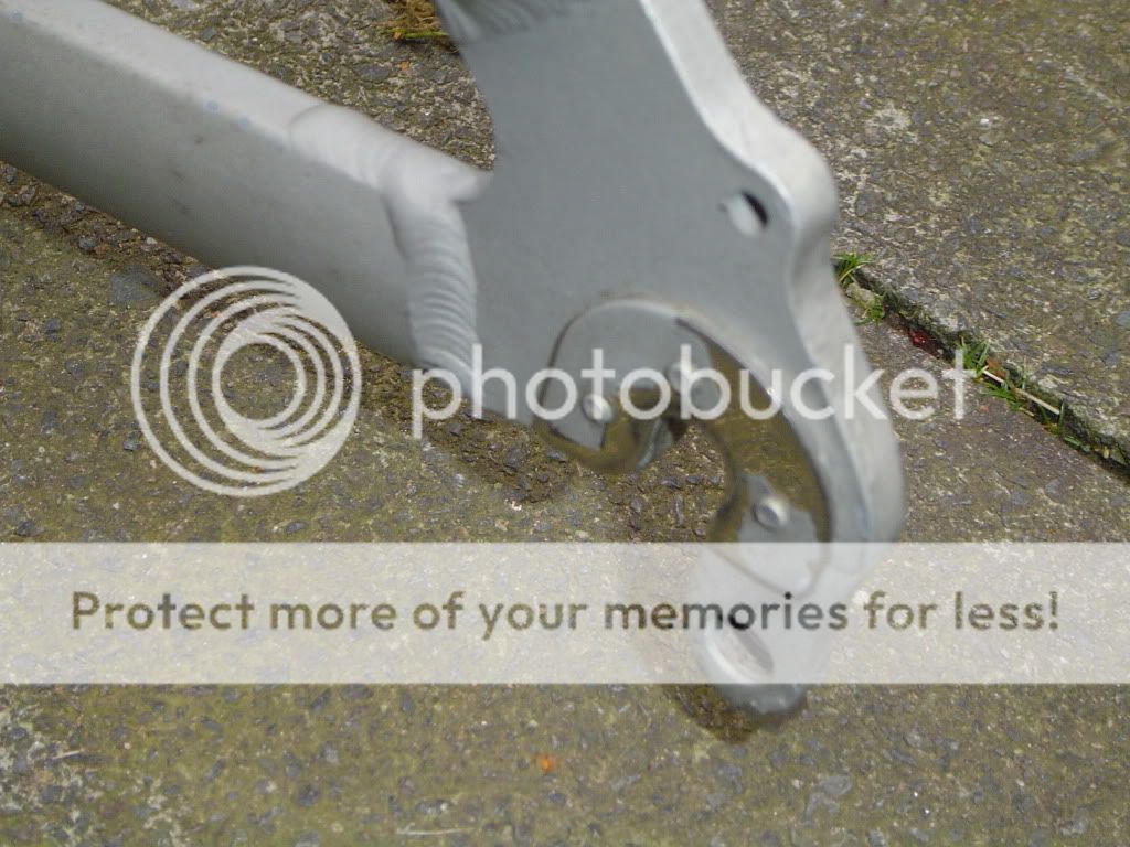

Ok here goes, pictures below of cable guides and mech hanger. Frame number is A1 120051.
So any idea correct size seat post and front mech band diameter?
Any ideas??
Thanks.
That is the 4th batch, has the welded guides and removed chainstay brace.. (which might contradict what I said before I cannot remeber) but have since noticed and info given to boy-o-boy
Boy-O-Boy should be able to confirm the serial number
Will be same as teh seatpost I mention 27.6 iirc as that's the shim that came out of one and band will be the middle one 31.8 (the middle size)
Alu-O are not fat tubed bikes, but skinny Alu one's

I mesaured the down tube width with my vernier and it was 33mm but I have realised it is ovalised slightly, so not sure what it should be.
Measure in between the bottle bosses, that's where you'r front mech will attach
just measured again between bottle bosses. It was 32mm.
However the mark in the paint from the mech is much lower where it was 33mm, that's assuming the previous owner had it fitted in the correct place :oops:
32 is the same as mine so 31.8mm band it is.
If it's lower than the bottle lowest bottle boss then the user used a modern low band/top swing style mech and will have tried to clamp it around the place where it is oval starting to.
Ignore and fit the correct style band ;)
