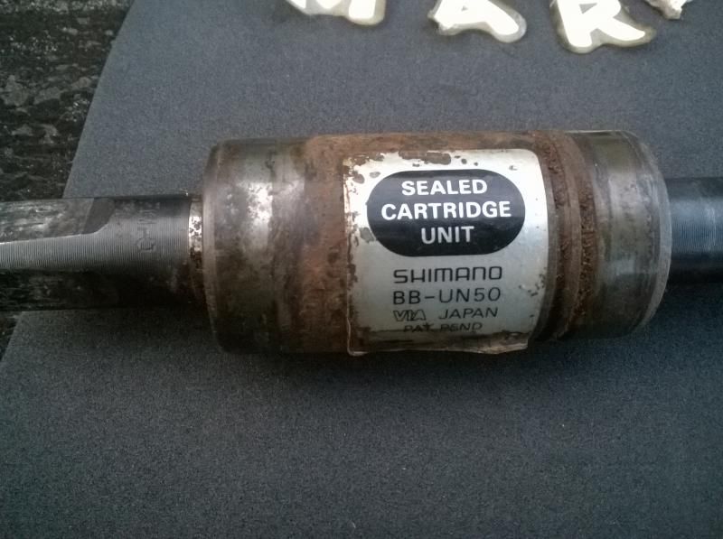

left side plastic cup removed check
sealed BB came out
tired extra lub penetration fluid.....
improvisation
started to turn
then it gave way
outer part has sheared off
is this now a goosed project or should i try with my metalworking neighbour to coax it out ?

Looking at the position of that breaker bar.... you did welly it the right way? the drive side shell is a left handed thread and should wind out clockwise. :oops:
Re: My Marin Bear Valley 1990 Project
I suspect you'll be able to hacksaw that out - and if you're careful, you may not even foul the threads.
What sort of penetrating oil did you use - I've found plusgas has been pretty effective. And as the other reply, not wanting to do the whole granny / eggs thing, but you were turning the right way, weren't you?

ehm it now seams no i wasn't
lesson learned

Ha ha ha hah hah hah :lol: ➡️ :oops:
Need to really rub it in now :lol: :lol: :lol:
The best thing to do would be to unscrew it not tighten it up :facepalm: :wink:
Anyways... faced with what you have now, I'd be tempted to chop into it with a hacksaw also.
Worst case isn't the cup alloy? Some folks on here have disolved out seatposts with caustic soda, that might work as a last resort.

its off came off easy too when you turn correct wy lmao,
there were just enough indentaions for shimano tool to grab.
doesn't look in too great a condition
thank goodness its scrap now would have been wooried putting it back in.

Excellent, glad it came out ok without needing to resort to drastic measures.
Probably the original BB there complete with quarter centuary vintage dried up grease, plus any water mud and rust that has found its way through the seals over the years. Worth parting with a few £ for peace of mind of a new un.

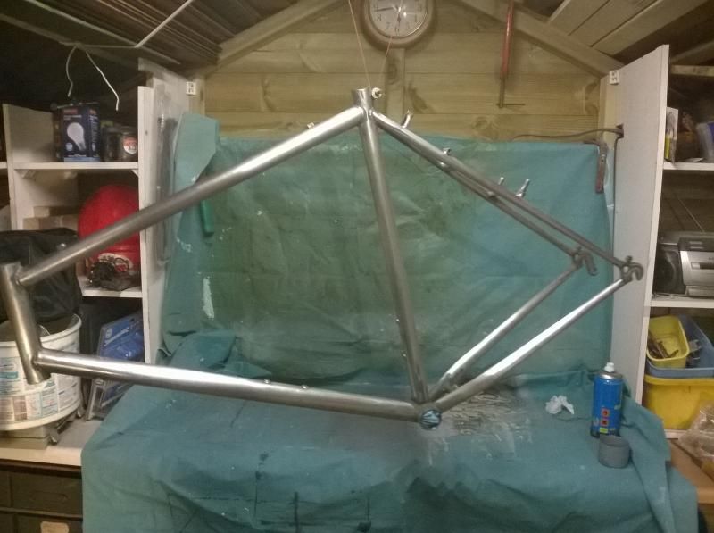

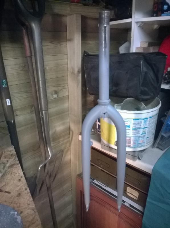

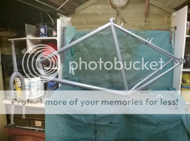

busy busy day in "man cave"
lots of frame and fork prep for initial primer coat lots of surface pitting remains but a couple coats of primer should flat that out
suspended by use of some fishing line two knackered drill bits and a 3/0 hook inside the forks
out of shot is my halogen heater (a 50th birthday pressie) to warm shed.
will re sand with 1000 grade wet n dry on thursday before a second primer coat.
assembled some of my shinny's i have collected so far
i think the old girl is gonna come up a treat :D :D
