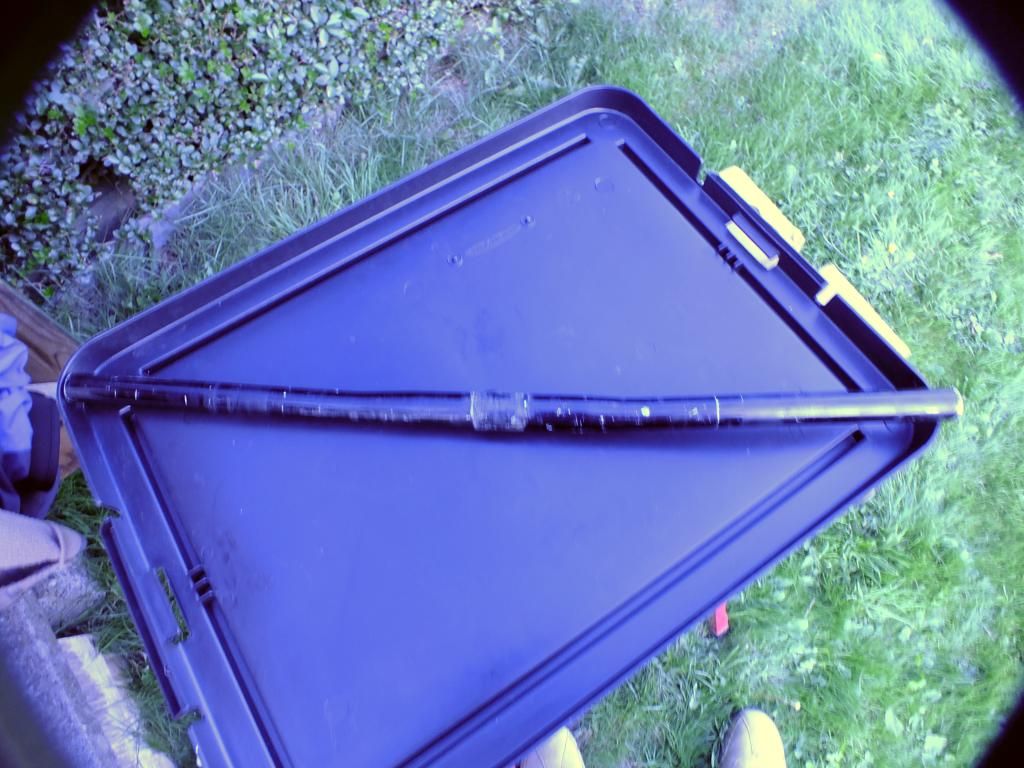

bars out of focus

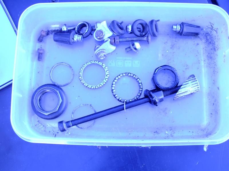

head set

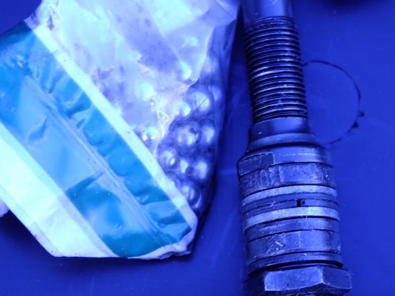

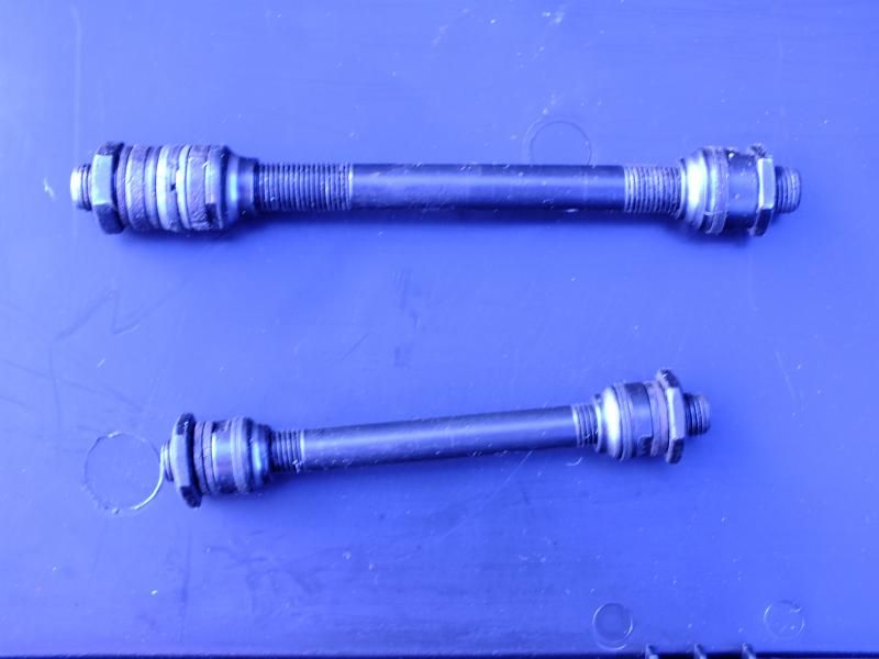

wheel spindles and bearings look ok

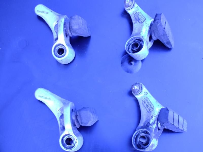

cantilevers

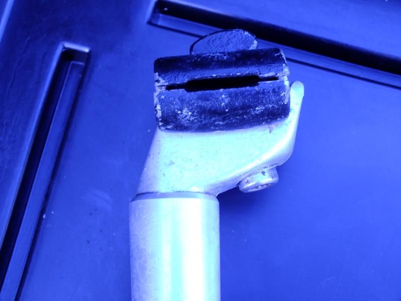

Seat post was clean a few months ago til my son took bile for a ride and dropped seat post from my hieght to his
bearings from forks upper was well oily lower was dry

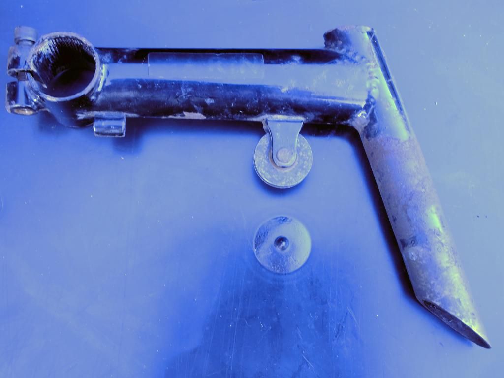

brake components and head spline

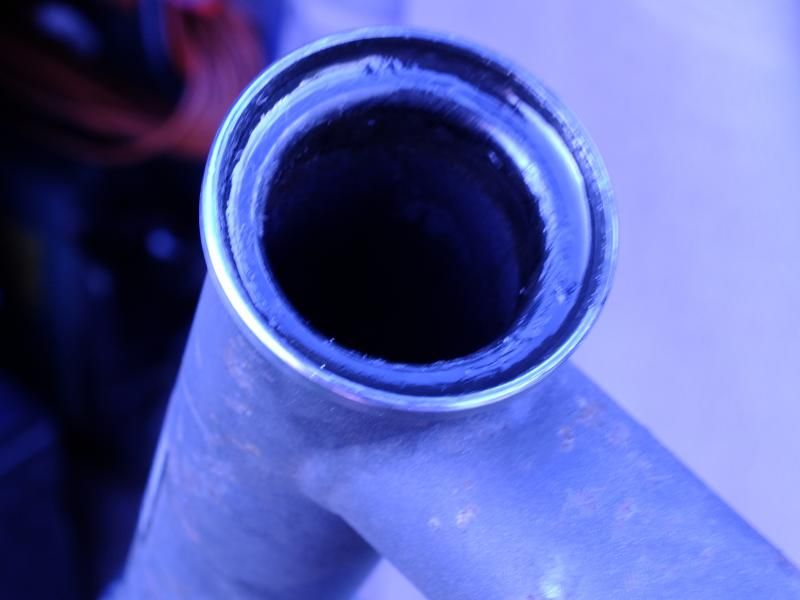

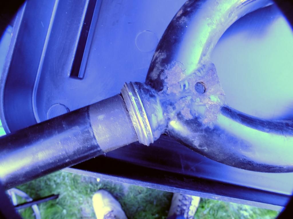

top of head tube

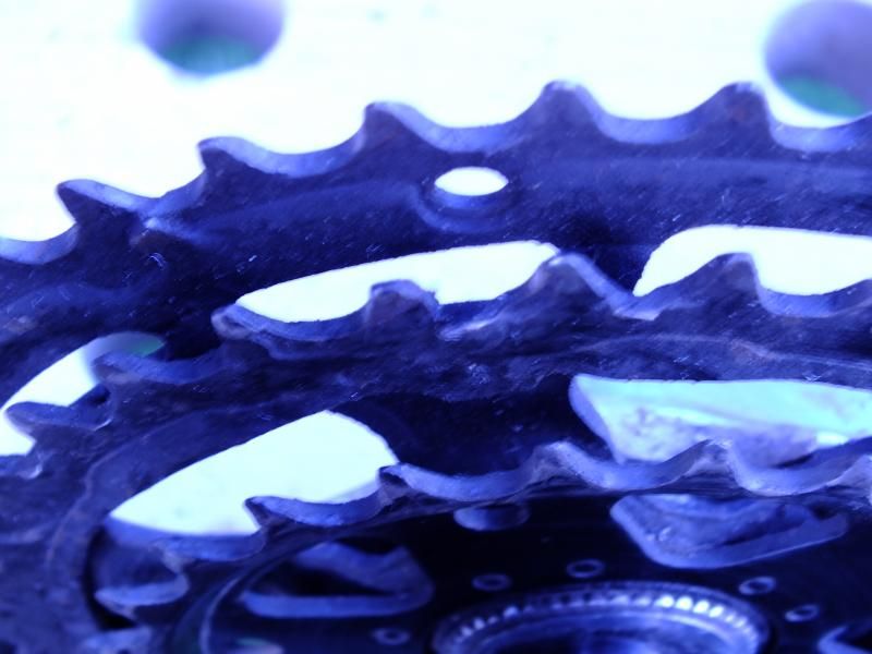

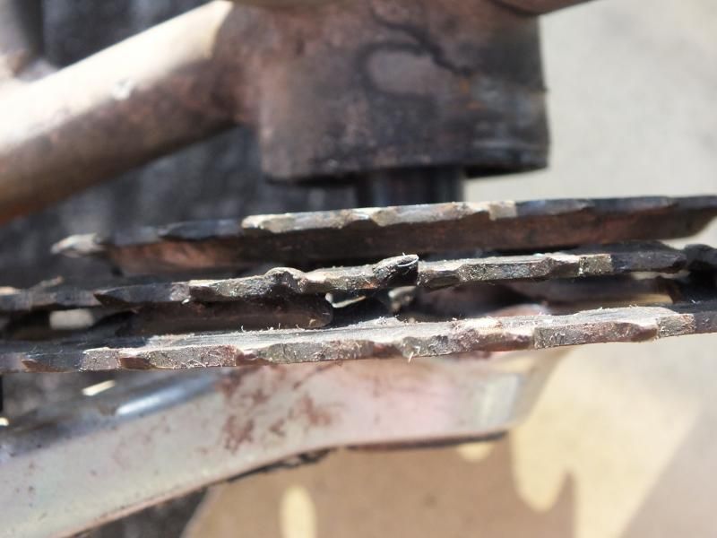

chainset thing this is for relacemant think 2nd ring has fractures??
