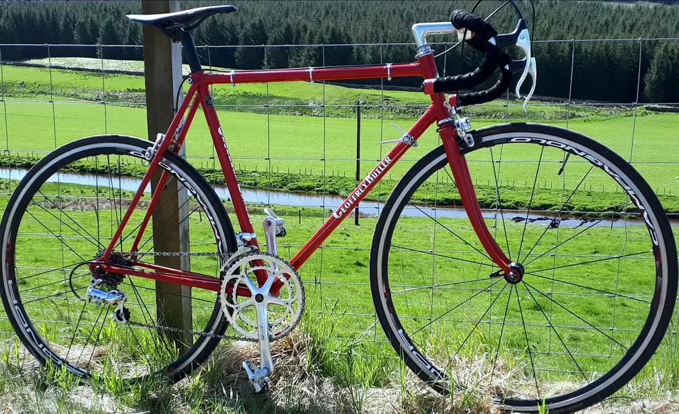

My Geoffrey Butler build 1 of 2

That's Very pretty!

Nice looking GB and yes that's an odd issue.
