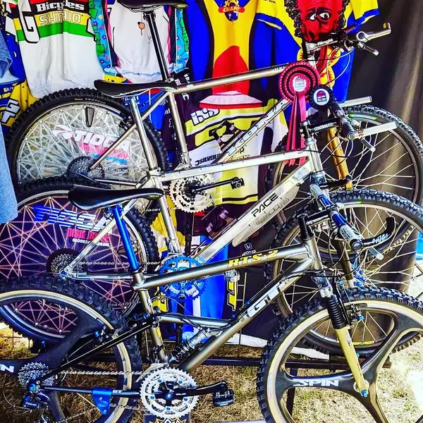

Was privileged to have my Pace RC200 F3 alongside a couple of my other retro bikes on display on the Bike Ninja stand at the 2021 GT Maverns Classic
@Tim-Bike-Ninja
@Tim-Bike-Ninja

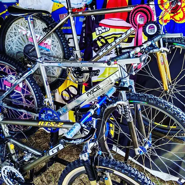

So onto the second "finished" build where I switched to NOS black wall Panaracer Smoke/Dart tyres, subtle period correct retro touches were added alongside a sprinkling of anodised blue titanium/aluminium bolts...
Full spec...
Frame: 1994 Pace RC200 F3 16"
Fork: Pace RC35AB
Headset: Miche Sterzo Speciale 1" (NOS)
Stem: Control Tech 0 deg rise 120mm 1" (NOS)
Handlebar: USE silver (NOS)
Grips: Onza Ules in black (NOS)
Barends: USE direct mount (NOS)
Brakes: Shimano XTR M900
Brake Pads: Shimano XTR M900
Brake Cables: Shimano XTR M900 (NOS)
Cantilever cable hangers: Onza Chill Pill anodised blue (NOS)
Brake Levers: Shimano XTR M900
Shifters: Shimano XTR M900
Front Derailleur: Shimano XTR M900
Rear Derailleur: Shimano XTR M900 with anodised blue mech hanger bolt and jockey wheels
Derailleur Cables: Shimano XTR M900 (NOS)
Cassette: Shimano XTR M900 (NOS)
Chain: Shimano HG71 (NOS)
Cranks: Middleburn RS2 175mm with anodised blue spider
Crank Bolts: Middleburn anodised blue (NOS)
Chainrings: Middleburn (NOS)
Chainring bolts: Middleburn (NOS)
Bottom Bracket: Royce Titanium
Pedals: Onza HO (NOS)
Hub Skewers: 1st gen Hope Titanium anodised blue (NOS)
Rims: Mavic M231 Sup CD hard anodised grey (front NOS)
Hubs: Front Hope Titanium Suspension anodised blue (NOS) / Rear Shimano XTR M900
Nipples: Front anodised blue / Rear Tioga Disk Drive
Spokes: DT double butted snowflaked front
Tyres: Panaracer Smoke and Dart blackwall (NOS)
Tubes: Panaracer (NOS)
Saddle: Flite Evolution Carbon (NOS)
Seatpost: USE silver with anodised blue clamps (NOS)
Seatpost Binder: Pace OEM with anodised blue titanium bolt
Extras: X-Lite top cap, custom machined 1" aluminium headset spacers, anodised blue titanium/aluminium bolts and Ringle H2O black bottle cage.
Weight: 23lbs
This build is kind of finished with only a couple of period correct Middleburn chinrings to source before I would truly class it as finished
I will be posting a new thread up soon of another 1994 dream bike build that I have recently started.
Cheers
Hatch
