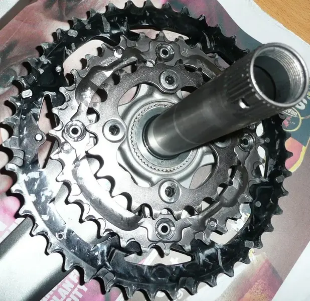

SO, my next question is are my chairings too worn ? Inner looks in really good condition to me. Outer seems ok. I'm finding it hard to determine if the middle is ok or not. What do you think ?
Oh, and its this shiny as I just degreased it !
By the way, chainset has been used for about 18 months, possibly 2 years. I bought it as end of line deal at a good price, and it then sat on my shelf for a while until my Truvativ bottom bracket started to sound gritty and the shifting started to go down hill on the old cranks.

Inner looks ok. Id say the middle and outer, youd be pushing your luck using them with a new setup.
Others' opinions may vary though.
