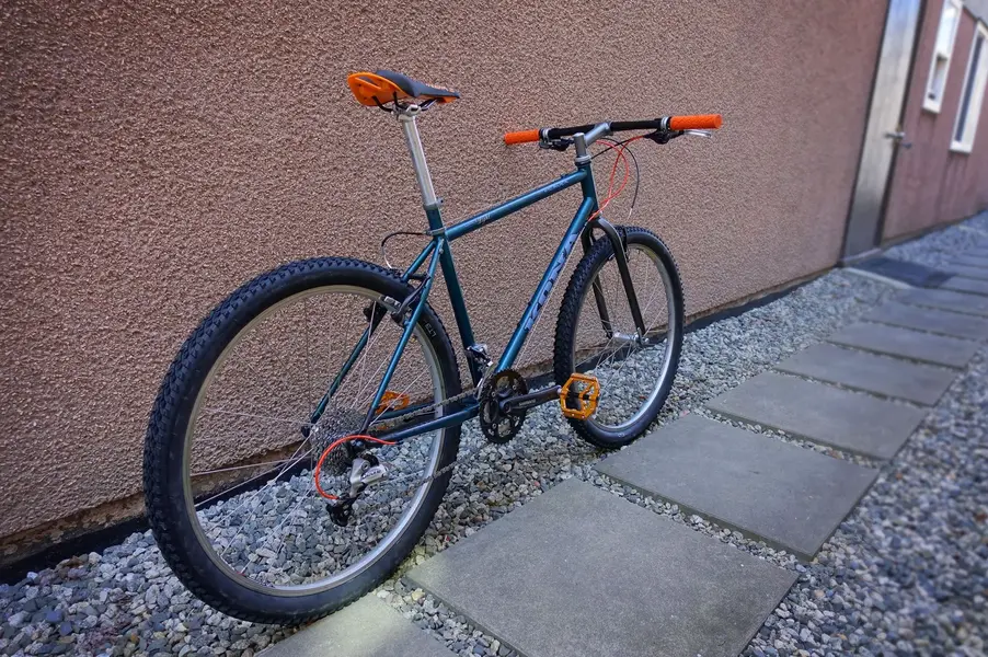

Just thought I would share a little project I've been working on over the last couple months.
I decided to overhaul and breathe some new life into a 1996 Kona Kilauea that was given to me a while back.
I did a deep clean on the chain and sprockets, mechs and the bike in general. I replaced and re-greased the wheel bearings front and back, re-greased the steering bearings. Touched up the paint in a few places with Testors laquer.
New parts:
- DRBike Seat.
- Bucklos 660mm handlebar.
- K PEDC pedals.
- Bontrager rubber grips
- Bontrager LT3 Hybrid tires
- Jagwire shifter cables and housings
- Vbrake noodles
- New brake pads

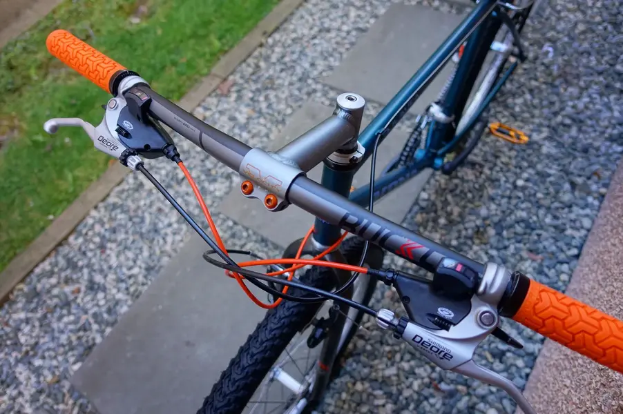

I have orange Jagwire brake cables and housings, but I left the Shimano cables for now as I kinda like the black/orange contrast. :) What do you guys think?
I've never so much as changed a tube before taking this project on, so I learned a helluva lot in the process! I'm pretty happy with the result overall.

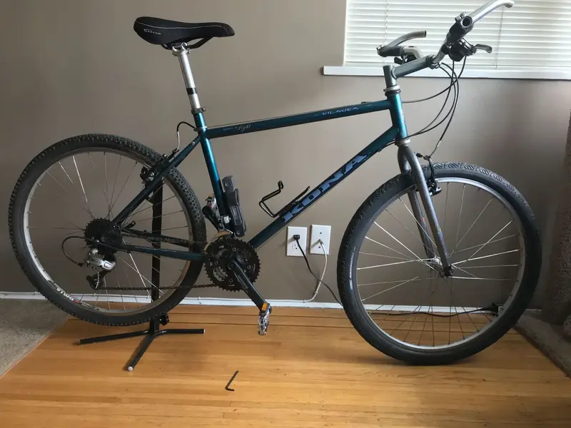

Before:

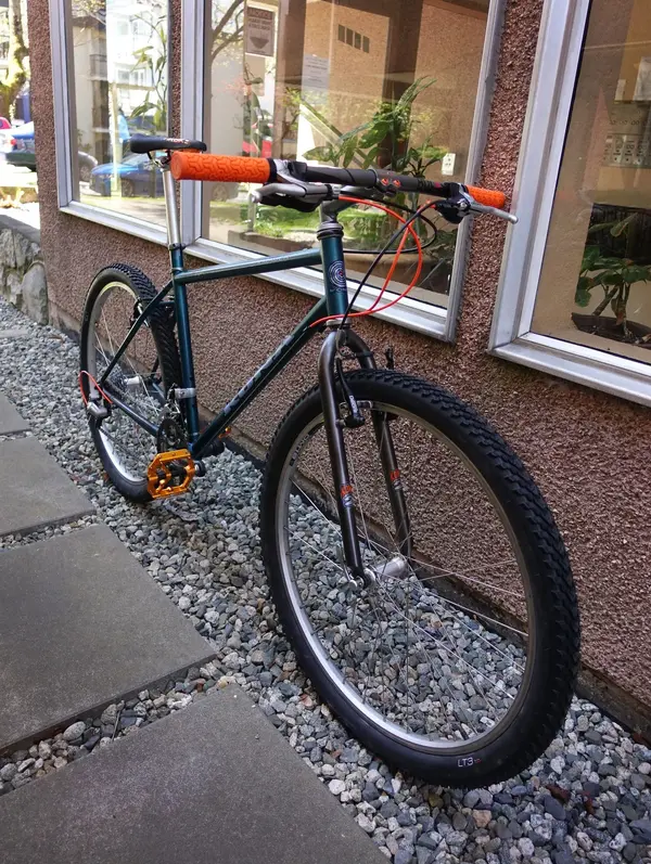

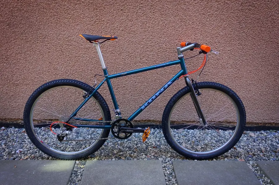

After:
I think you've done a fantastic job especially considering you've not even changed a tube before.
