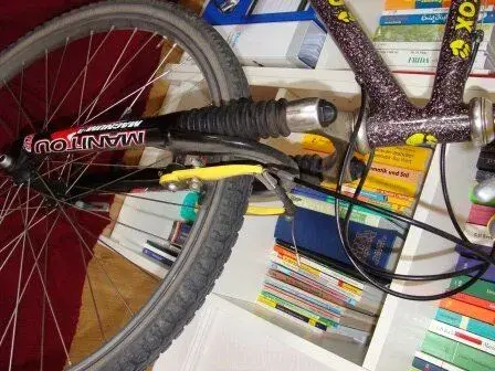

Nice Bike! Really like it - inspired me to rebuild my own Muddy Fox Prestige Pro!
Does anyone know the production year of my frame and wich name it had in the UK (it was bought in Germany)?
My dad gave the Frame to me when I was 12 years old and fitted an black LX- frame was kind of disappointing (all that pink). Then some years later my dad decided to rebuild it with a new fork and yellow V-brakes. I hated that even more. Now it will get a stiff fork canti-brakes and black post, stem and bar. Parts are ordered - looking forward to build it!
Thanks for the inspiration!
