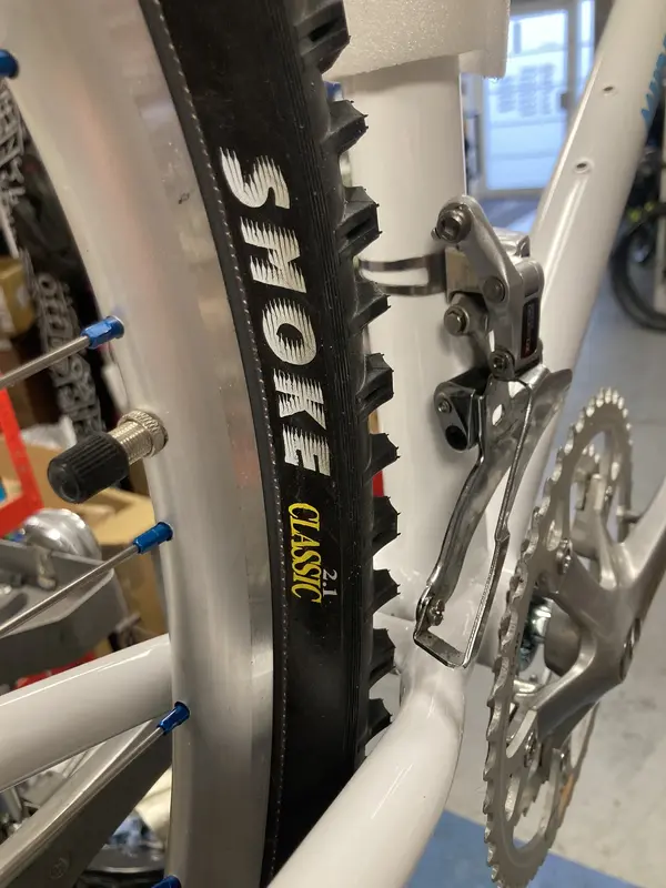

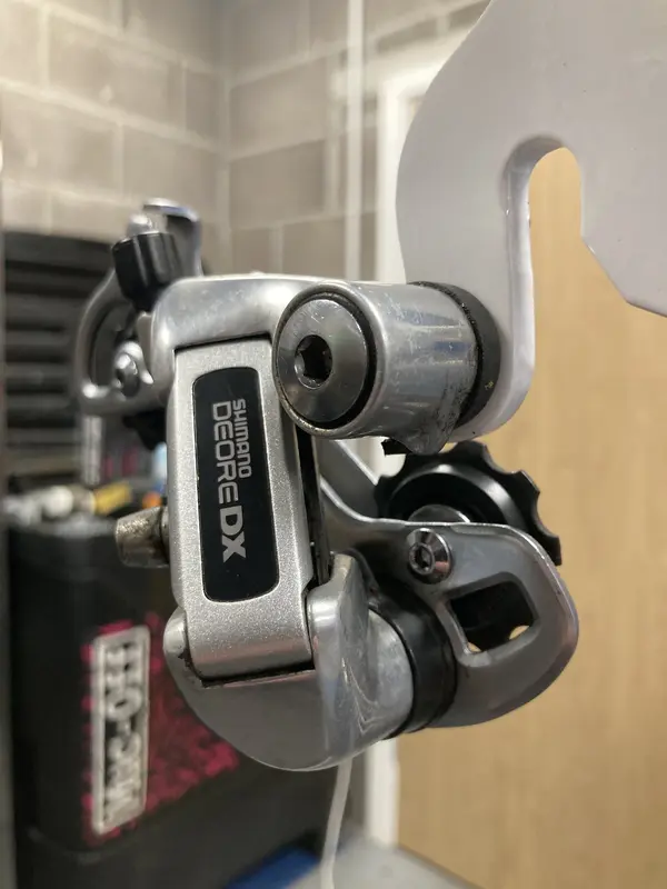

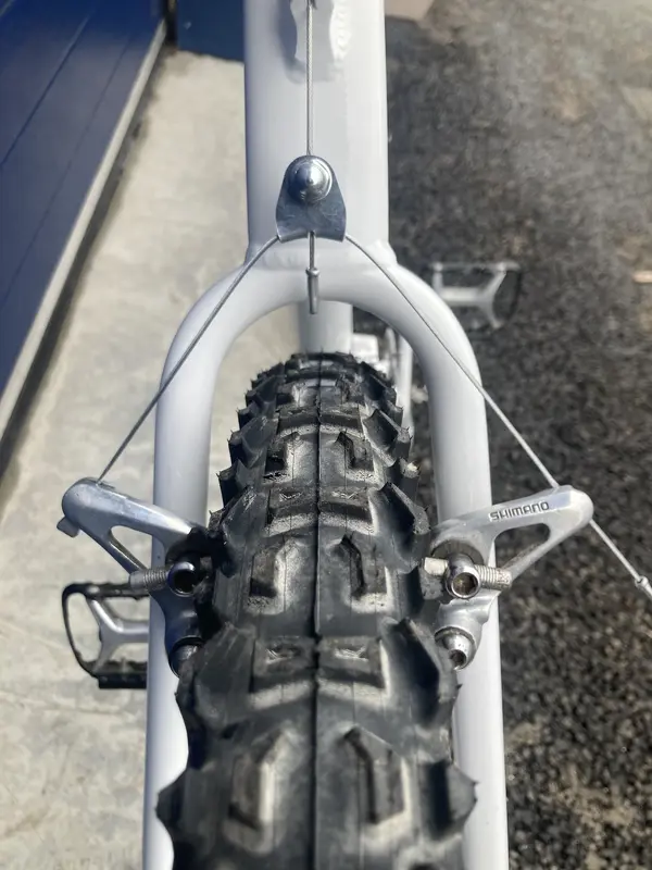

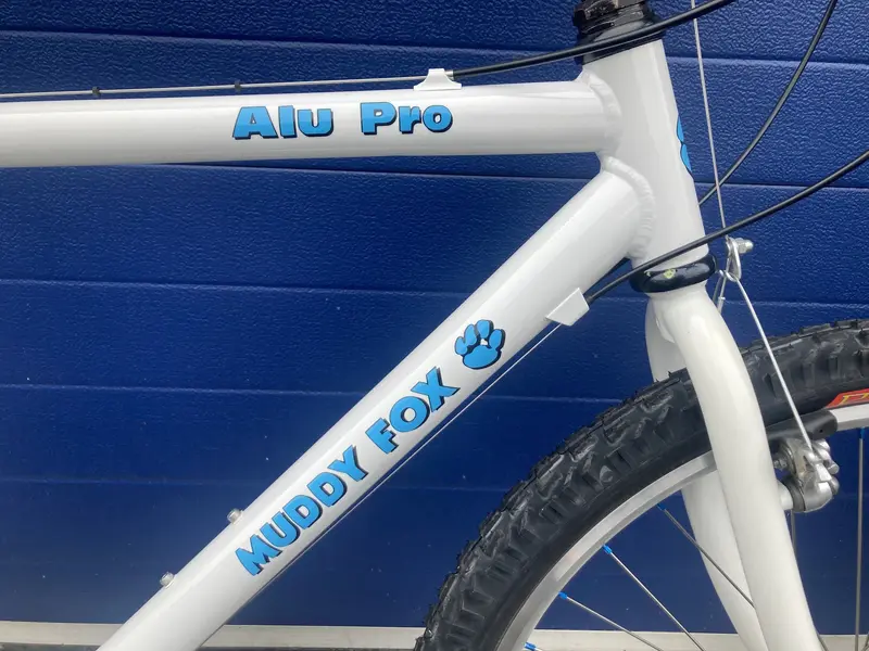

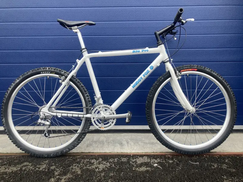

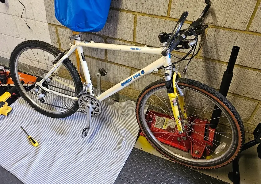

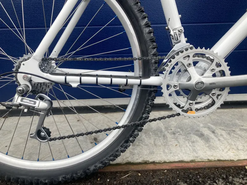

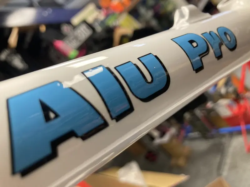

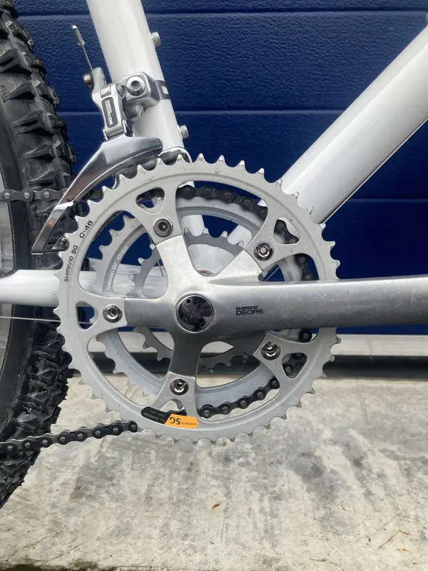

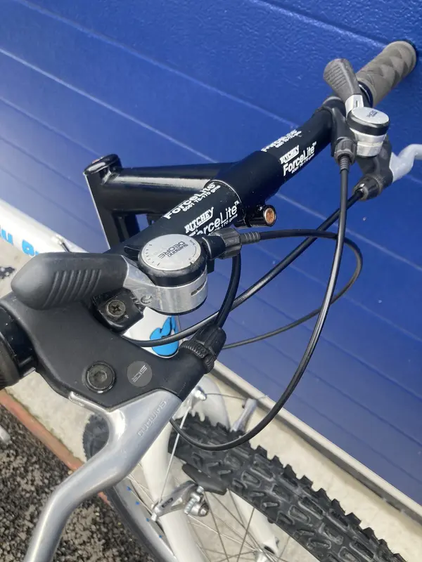

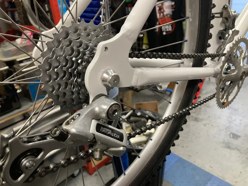

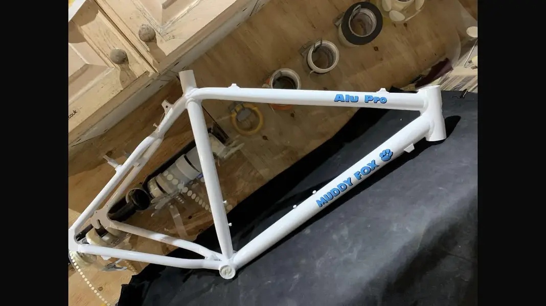

no messing about! as soon as the box with the fork got here the MF was back in the work stand!

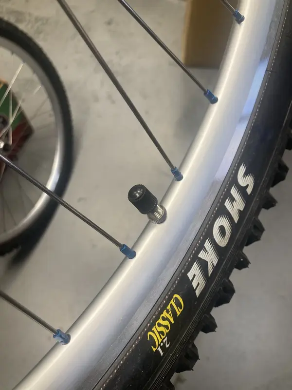

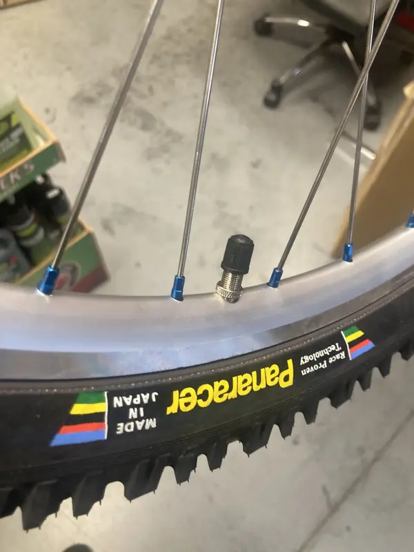

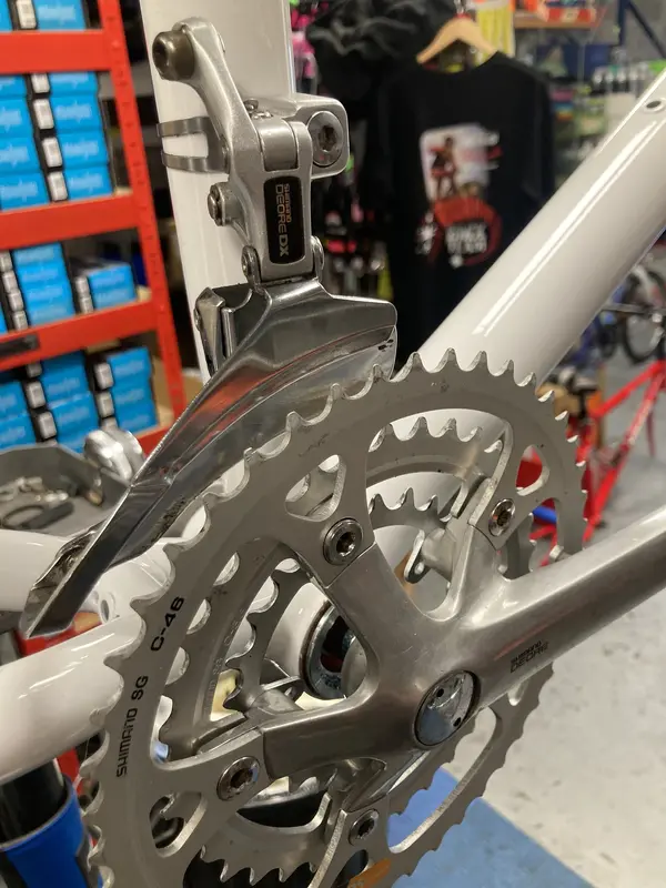

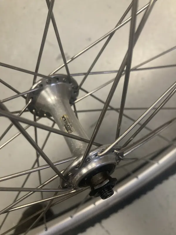

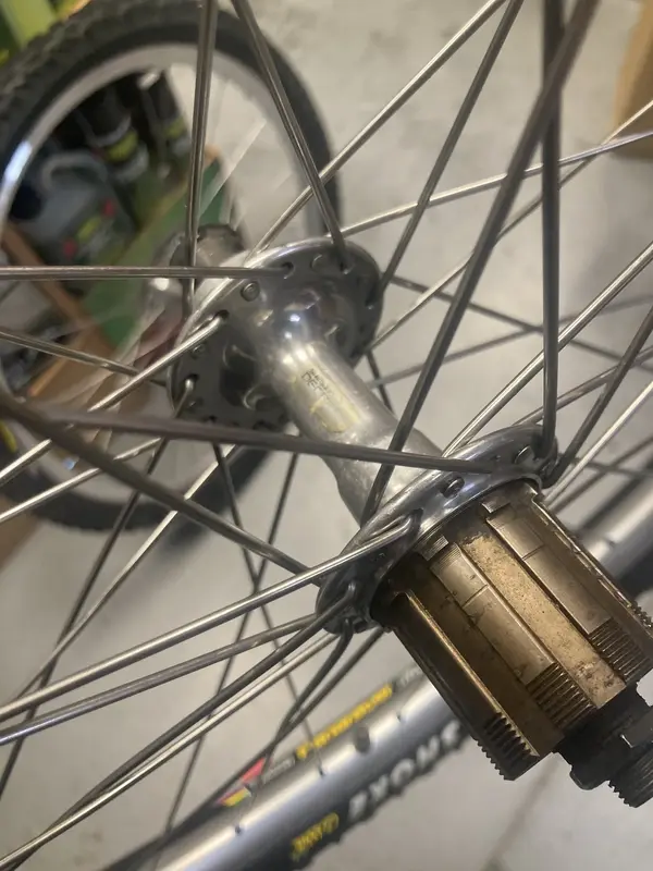

so i have used the DX shifters from the Proflex, that has been played with as well so it now has XT thumbshifters and rear mech, so the Muddy Fox is pretty catalogue accurate now. will fit some DX hubs at some point, and the rims are modern double wall with a machined surface so the brakes are ok, need some nicer pads for the front brake as they are basic, oh the only other thing is it has a modern BB., i had a DX bb but i's for a 68mm shell and the MF has a 73mm shell.
see pics!
That looks bl**dy epic!!! 😲
@JCS the one thing i hadn't done!! :rolleyes: ;)i'll sort it at some point when i find an appropriate bolt
@PhillB cheers
@brocklanders023 maybe, i built these wheels with LX hubs because that's what i had, then doner bike i hvae has mint DX hubs but they are laced in to 700c rims, so i couldn't be arsed to rebuild them, but if your wheels are sensoible price i'm sure we could chat!
Yeah mate, they will be or maybe a swap? Remind me in the next couple of days as I'm working tomorrow.

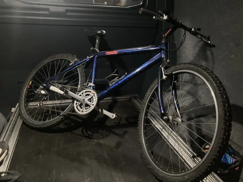

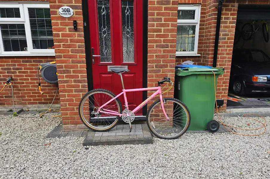

Had one but turned out that the previous owner had covered up some damage, so sold as spares/repairs and got a lovely pink one.
