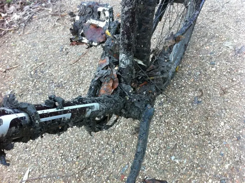

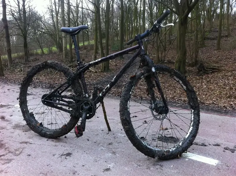

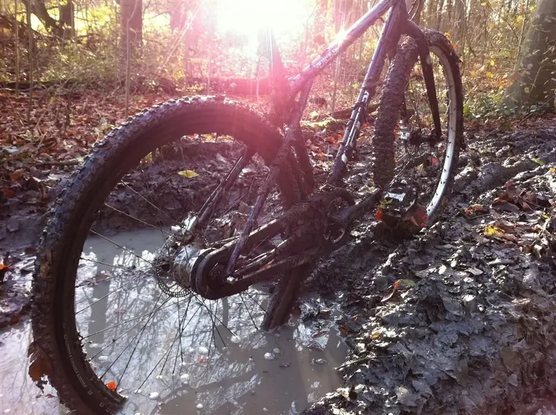

Hi good topic,
indeed mud in these low land regions tends to spoil all the mtb-fun; resulting in more time spend on cleaning instead of biking. Plus I hate the noise of sand and mud grinding and eating a way through your expensive derailleur setup. And even worse: after an hour plowing through sticky mud the system does not even shift properly anymore due to the concrete like structure of mud and leaves (an ancient form of a 2k raisin they used to build houses from!) completely immobilizing your front derailleur leaving you screaming at the darn thing while not making it up that short steep hill.
my 2 cents :wink:
So hereby my recent solution to the problem: a cheap steel GT with alfine 8 hub and Hebie chaincase. Weighs a ton, but other than that it's brilliant.

Wytze":3vdrdbaq said:
Hi good topic,
my 2 cents :wink:
Brilliant! I'm glad I'm not the only one in BNLX who wants to try this sort of thing.
Most of the mountainbikers near me seem to give up on the MTB trails altogether in the winter and just ride around on bridleways. But that gets pretty boring.
One advantage is that components like Nexus seem better supported here than in the UK.
Cheers for the pics, very helpful.
