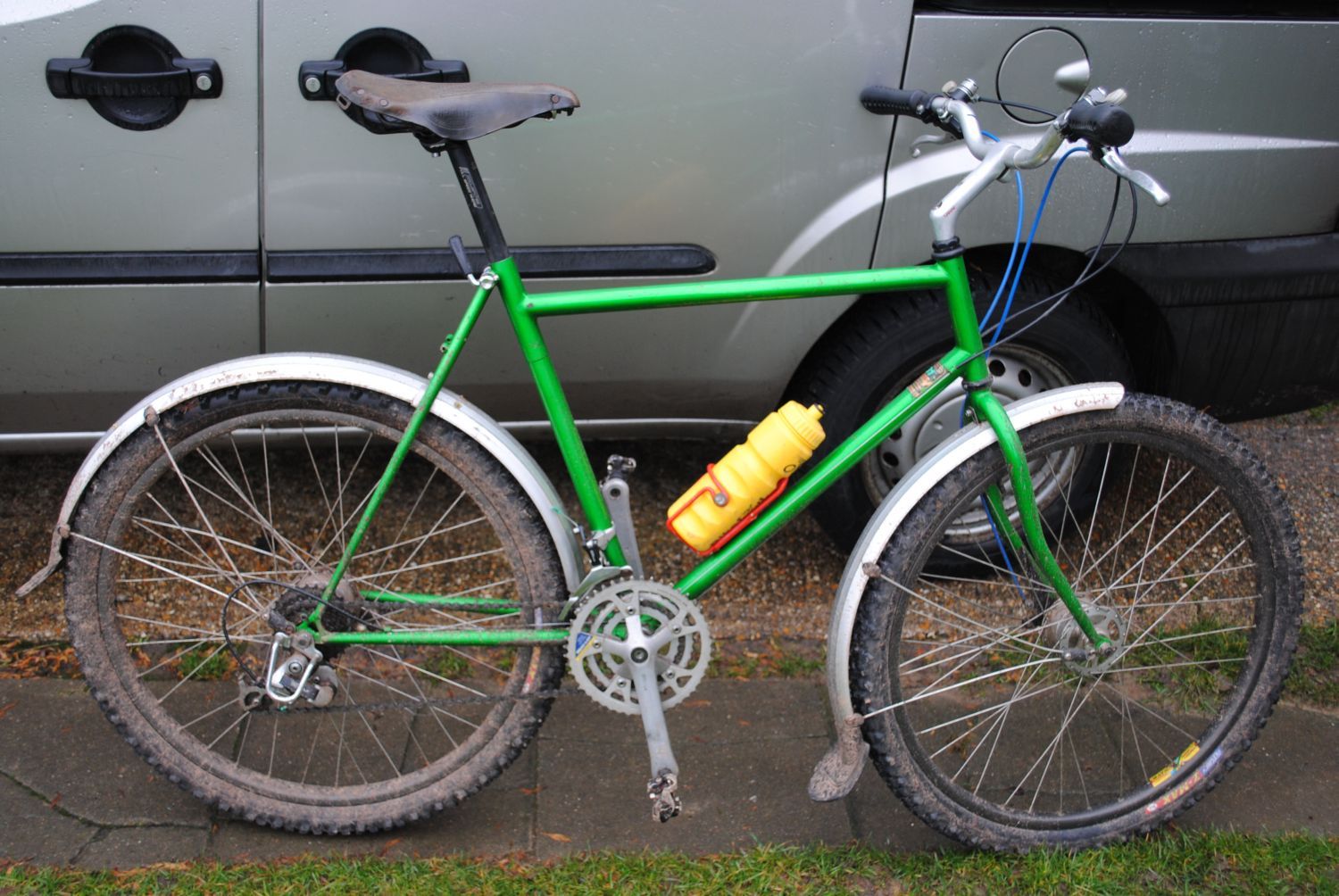

1) Can anyone suggest a decent hub brake? I saw that on the original bikes
they were using old moped hubs. Is there a more easily available alternative? Surely not Shimano Nexus?
2) How do they cope with descents? The trails I ride include some technical-ish descents and I'm curious about how the Clelands would deal with that.
Yep, Shimano Nexus (or Nexave) IM70 Roller Brakes. Cheap, bombproof, almost zero maintenance, and work brilliantly!
They are full of grease, so unaffected by drowning. Maintenance consists of squirting a bit more in and twiddling the cables every year or two.
Mine have been working for six, nearly seven, years; consistent and reliable braking with no worries if or how they will work, no cleaning, no adjusting, no replacement shoes or pads.
Looks like they're good for another six years. When they're worn out, disconnect cable, remove wheel, undo nut, remove old brake, slip new one onto the axle, tighten nut, wheel back into bike, reconnect cable ~ and that's it!
I really could not care less that they weigh as much as the breakfast I eat before riding.
I'll see if I can post a headcam video of some technical-ish descending on a Cleland...
Here's a link to the video: http://vimeo.com/56721351
It was taken on a mobile phone strapped to my forehead, so quality not brilliant.
Also, a mobile's mic seems particularly attuned to all the grunts and puffings of this decrepit old geezer hauling a 47lb bike around (looking forward to the new, lighter prototype to be completed this summer).
...and that's not a protracted fart near the end, it's a stick caught up in the rear wheel.
That's my story...
Is that technical-ish enough? The sort of thing you do?
