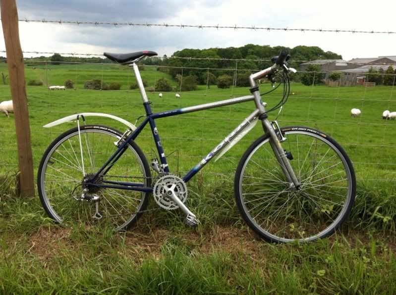

I run continental Grand Prix in 26x1.1 on my 93 lava dome, i believe 'kingoffootball' runs them on his zaskar on a 1.0 fitting, i need to change my tubes to presta valved ones as schrader valves let a lot of the air out when you try to pump them up to 80+ psi then remove the connector lol
But the bike flies with them on, so pleased with them :D
Bought from a seller on the old bay for £39.99 the pair!

the only problem I've had was which I hit a concealed curb in a cycle path with them.

Mine are on the original rims with no bother whatsoever!
