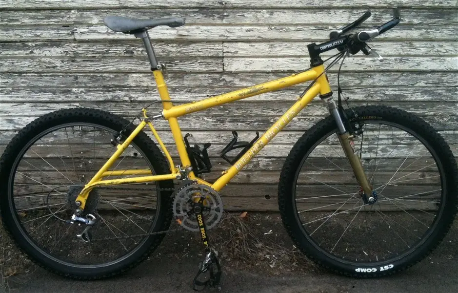

Thanks guys, i'm quite smitten with the bike. More pix below.
Here is a rundown of the current, and mostly original build (so I was told):
Frame: 1991 Boulder Defiant 26.6mm seat tube, 1 1/4" head tube #00051
Fork: Rock Shox Mag something...
Headset: King, no logo
Stem: Control Tech quill
Handlebar: Answer Taperlite, Onza bar ends
Seatpost: American Classic Ti
Shifters, F&R derailleurs: M900
Brakes: DiaComp 987
Cranks: Cooks RSR
BB: Not sure but appears to be ti
Wheels: Bullseye front, XT rear, Ritchey Vantage rims
Tires: some horribly heavy and ugly CST's.
Saddle: 1991 Flite
Current weight is 29lbs, this will change for the better I hope.

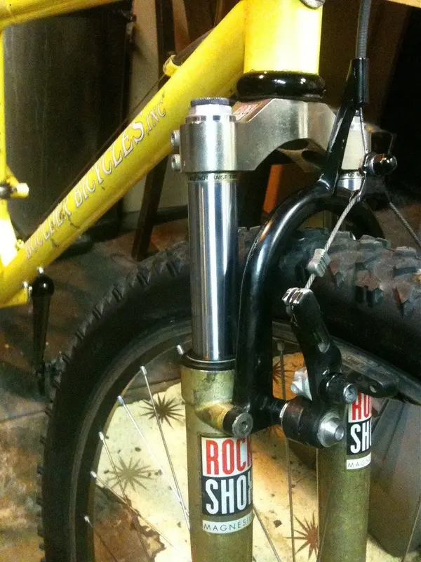

A couple more pictures posted showing the front end and rear cable routing. Fork is holding air and rebounding nicely, i'm hoping it will not require a rebuild. Mag 20?

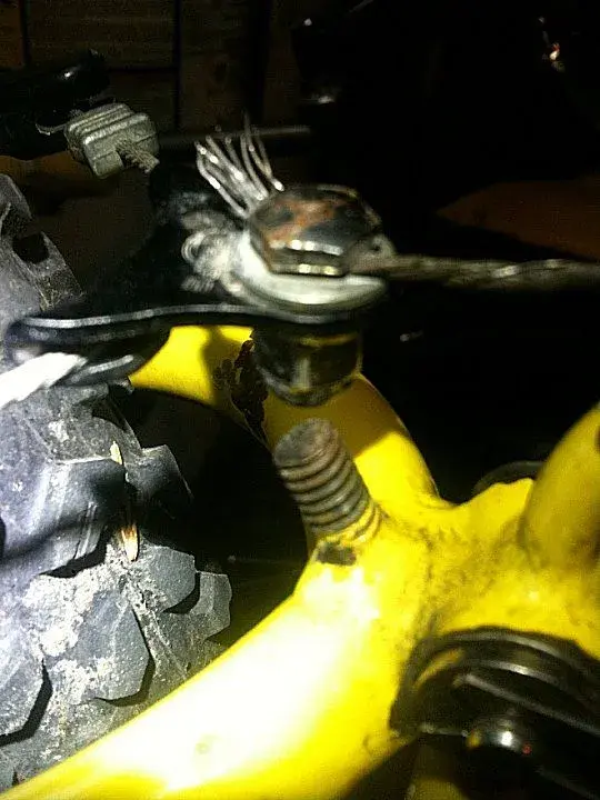

I also took accurate measurements of the rear drop out spacing, 145mm, which I believe is spaced for a tandem hub. The rear hub is currently a M732 135mm, the drop outs were crimped together to make this hub fit. Not cool.
There is also a threaded part that was added as a fender mount on the rear swing arm. Seller stated that this was added by the original owner as a fender mount. I will have this removed when when I get the seat tube repaired.
