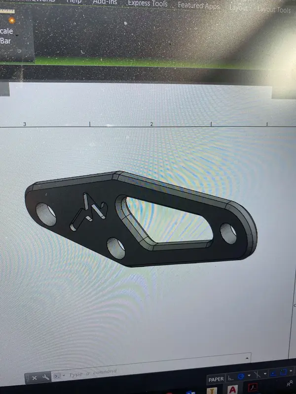

Yeah. It’s had a lot of work done since then with custom made mounts etc. This is it now with a powder coat chrome finish. ’m still going to shorten the shock stroke by 3-4mm to get the bb lowered a bit further.
