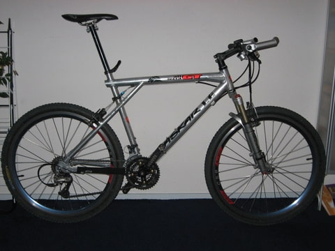

Purchased a 1992 Zaskar Le last year wich was equipped with a Manitou Axel forks. Think it was a 80 mm travel. Besides that it looked really horrible it did feeling steering quite different )slower' then with a Rock Shox Mag 21.

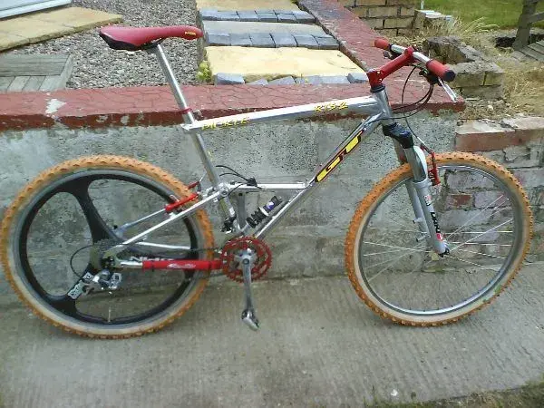

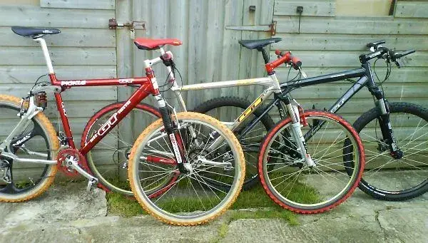

Its all in the headtube geometry, which you can see on this pic of all my GT's.
Hope this helps :wink:
