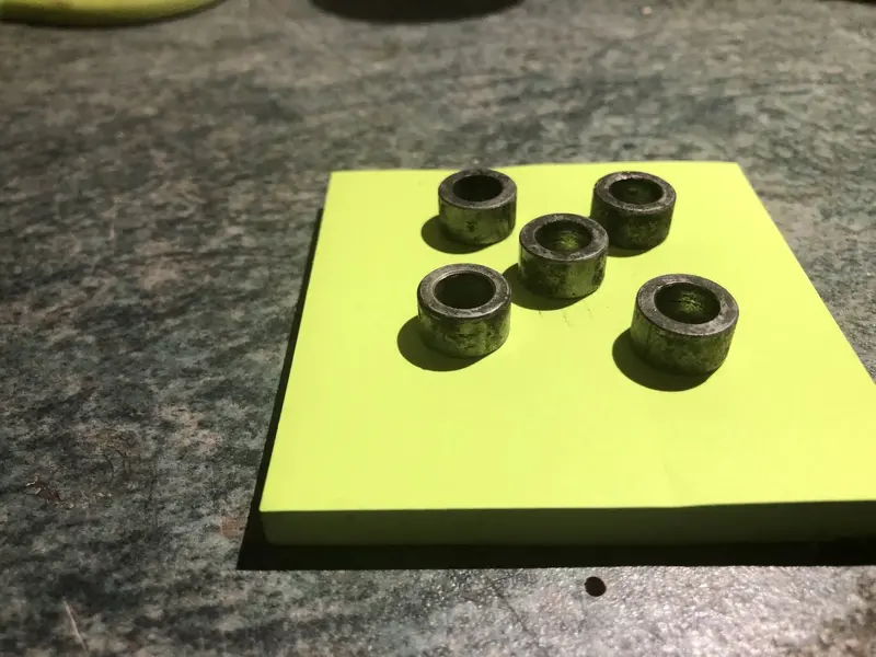

Hi fellow retro biker. I had this very same dilemma a few years back. Happily, I bought a stash from SJS cycles after talking to Middleburn. These should fit, if I’ve remembered the right box I put them in. I’ve got some used spares, which are a bit mucky, but should polish up. Let me know your address and I’ll post them to you, just cover the post at £3.00 (insured and tracked). Peace and love, H.
