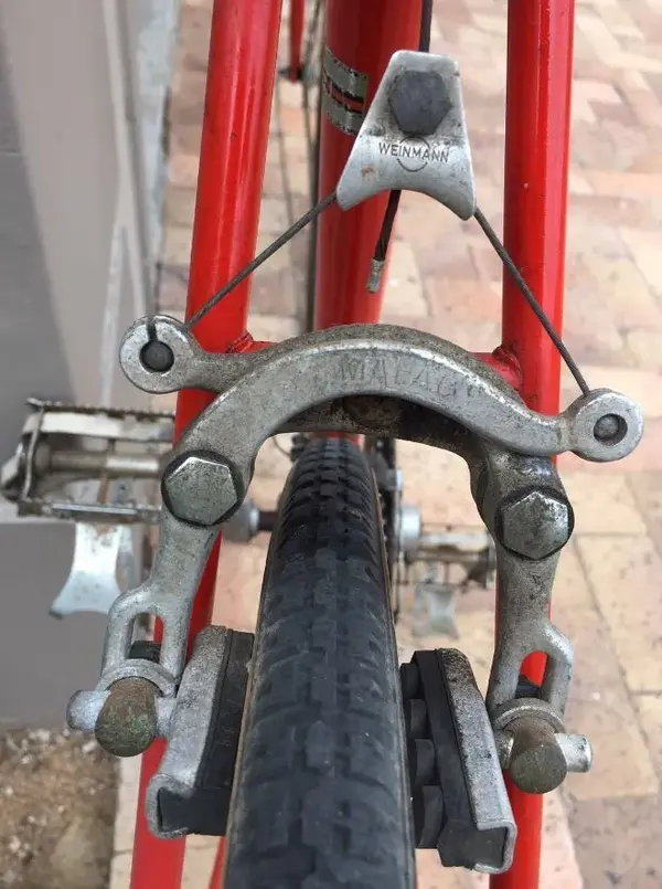

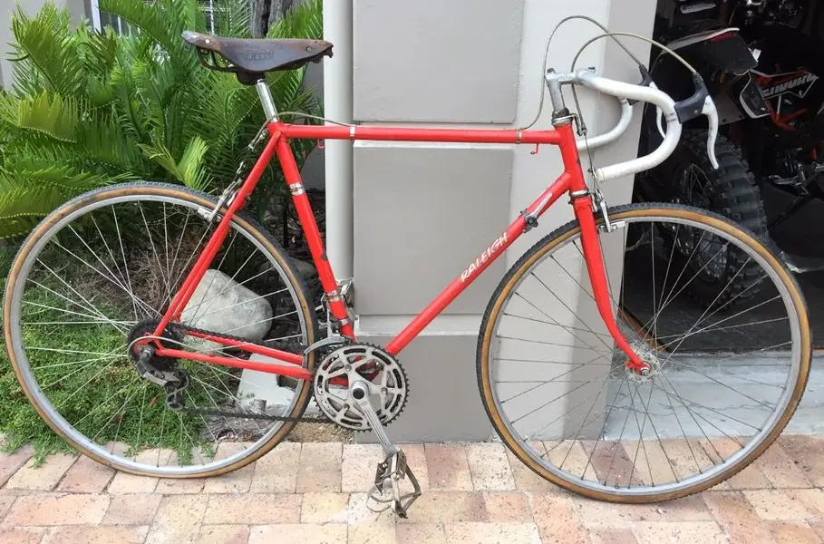

This particular bike is probably dated around the mid/late 70’s but I’m not 100% sure. I’m not too sure of the model either because it has no distinguishing features on the frame. It’s certainly not a top end frame (the brace for a rear mudguard gives that away) but the components are fairly light weight and appear more suited to a race orientated frame. It has a mixtures of components, with full Huret levers and front and rear derailleurs and Mafac brake levers and callipers. It has a fairly unique SR crankset as well. It certainly seems to be speced very different to similar dated Raleighs from Europe.
The saddle is also a fairly unique piece on the bike. It’s plate states “Lycett made in South Africa”. My search history tells me that Lycett was bought out by Brooks in the 1930’s who continued to produce cheaper version of the Brooks saddle under the Lycett name. I was not however aware that they had a factory in South Africa and I’m currently investigating this further.
I picked it up at a very reasonable price of around 50 pound (converted) but it needs a lot of work. Fortunately most of it only cosmetic as it seems fairly original and complete with no broken parts. Some of the chrome bits are however in very poor state.
The bike “as bought”

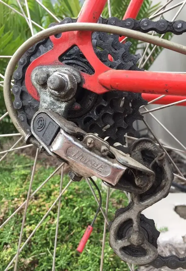

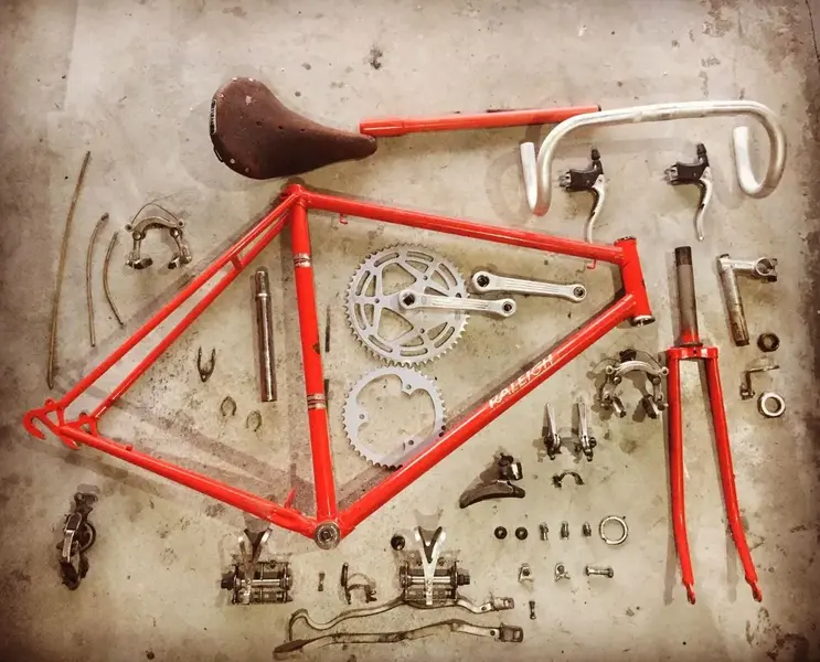

Being fairly new to the restoration thing my enthusiasm is still very high so it didn't take me long to reduce the bike it a pile of parts. It came apart surprisingly easily and the only part to suffer under my impatience (I'm working on it) was the left side crank cap. Regretfully because it's marked with the SR logo but if that's the worst of it then I got off fairly lightly. This happened during the course of last week.

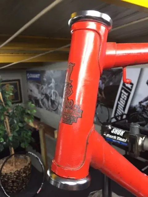

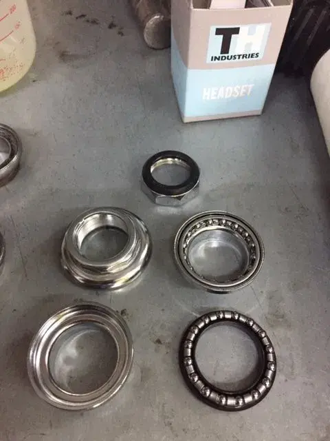

The issue with Raleigh 26tpi fork thread I learned the hard way. I went to a mate bike shop with the frame and fork to replace the headset (because he's got all the right tools) and got stuck in right away. All went well removing and replacing the new cups but the problem came in when I got back home and installed the bearings and the headset nut... it only went down half way. Hmmm... we have a problem x 2 :? Firstly it didn't fit and secondly, I had thrown the old top cup away at the bike shop and the old nut didn't fit the new cup & bearing. Phoned up my mate and had him dumpster diving early the next morning looking for my old cup :oops: Fortunately he found it so now the headset will sport a new lower cup and bearings and the old top cup and new loose bearings until I can order in a Raleigh 1 inch headset from who knows where.

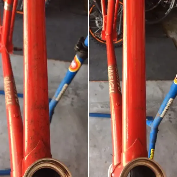

To soak up my disappointment with the headset issue I decided to put in some effort on the frame and see if I could make some sort of improvement on the dull and rust spotted paint job.
We don't get T-Cut in SA and with it being a Saturday afternoon, all the automotive suppliers were closed so I tried what I had... Autosol. Low and behold, it did a fairly impressive job. Here's some before and after shots.
I got a NOS Raleigh headset on eBay but it had to come from the USA. Do NOT have the head tube faced and reamed at the top...Raleigh cups are more like JIS (30.0mm) and will be loose if the head tube is reamed for ISO (30.2mm).
I'm with rogerzilla on this. The old Raleigh headset cups are incredibly hard wearing, they'll run for another 40 years no problem. I'd personally just reuse them with good quality grease and fresh balls.
Paint came up well!

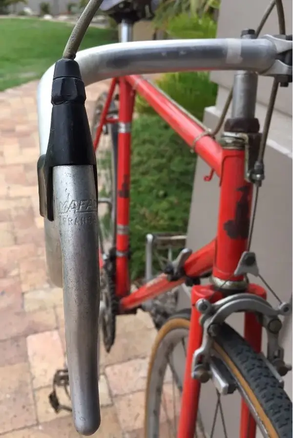

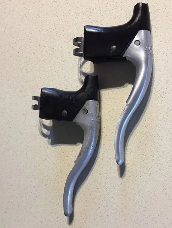

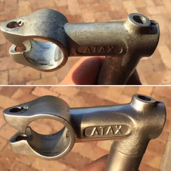

I also gave the stem some attention on the weekend and got it looking a lot fresher. I decided not to polish the aluminum parts with Autosol as I don't want the gleaming shine finish of a new bike so I simply used a Scotch-brite pad on my drill to give me the finish I was looking for. I tried it on one of the Mafac levers as well and I'm happy with the result.
Opinions would be appreciated though?

Loose bottom cup won't be a problem - just stick an ISO bottom end in there as the cup is 0.2mm bigger and it will be a perfect interference fit. You will need to get the crown race seat cut to ISO 26.4mm (10 minute job for any half decent bike shop) or use a JIS crown race that works with an ISO bottom cup (e.g. Tange - only the crown race actually differs between JIS and ISO in their headsets, and all the other components are the same). You can even use a Tange Falcon cartridge headset and, although, you can't use the top end as it's 24tpi, you get a spare cartridge! Do cherck stack height before doing all this but Raleigh headsets were pretty tall, so you are unlikely to have issues.
The top end has to be 100% Raleigh. The races are U-shaped and not angular contact like modern ball races. However, this doesn't cause any problem. I'm running exactly such a frankenheadset on a 1980s bike.
