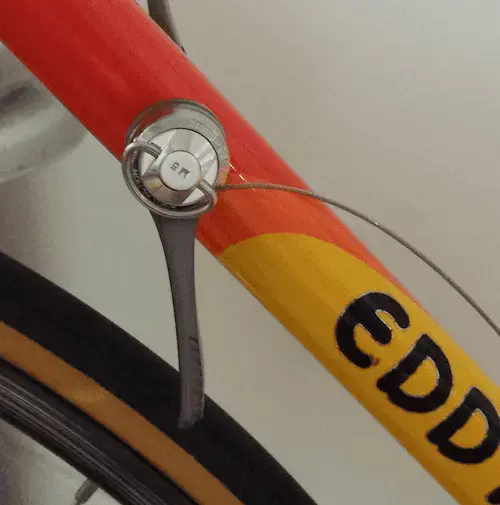

As for the front shifting, should the shift lever spin (forward) past parallel to the downtube? If I keep pushing, the shifter will keep going until it's pointing straight down (literally). The shifters were purchased NOS, still in the box, but the box was open so not sure if the every single part was included...
Not sure how you've set the shifter but no, it shouldn't be going that far forward.
Maybe I'm reading that wrong but neither lever should go that far round.
Stick a pic up if you can, I'm just having trouble visualizing it that far round.
Jamie

I think you have them on the adjusters 180 degree out, Looking at my Long Haul Trucker in the next room my adjuster is sitting pionting up. Is the tension set properly? There is a small washer with a tab on it from memory, maybe that is round the wrong way.
I am busy for the next hour but I will pull mine apart and take a picture so you can check.

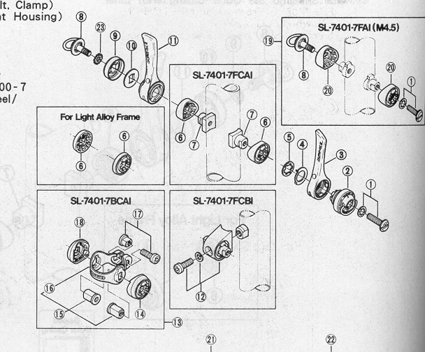

Not sure if this is the correct model but if not a google search should show up a parts diagram that may help.
But your shifter should not turn that far round.
