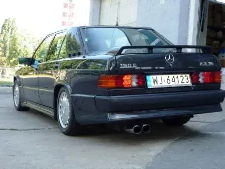

Hi, talking about one ninety I have this one.
Really nice car. Built in 1987. t is a 2.3-16 with full leather seats and - what is not so ordinary - adjustable suspension on all four wheels (usually these had nivo on rear axle only). So a "track" and motorway / normal and high level can be chosen. Evos had it as standard and lowered themselves automatically with higher speeds. I can't tell you much about how she is as an everyday runner as I drive my Benz rather rarely. I still have problems with rear susp, so it jumps like a ball. Most probably new pressure accus are needed. Have to fix it this year :?
