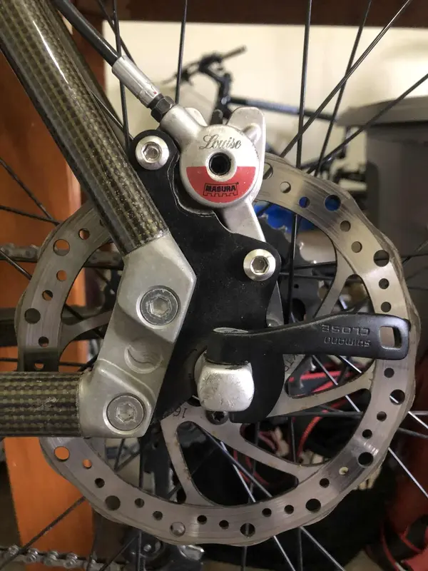

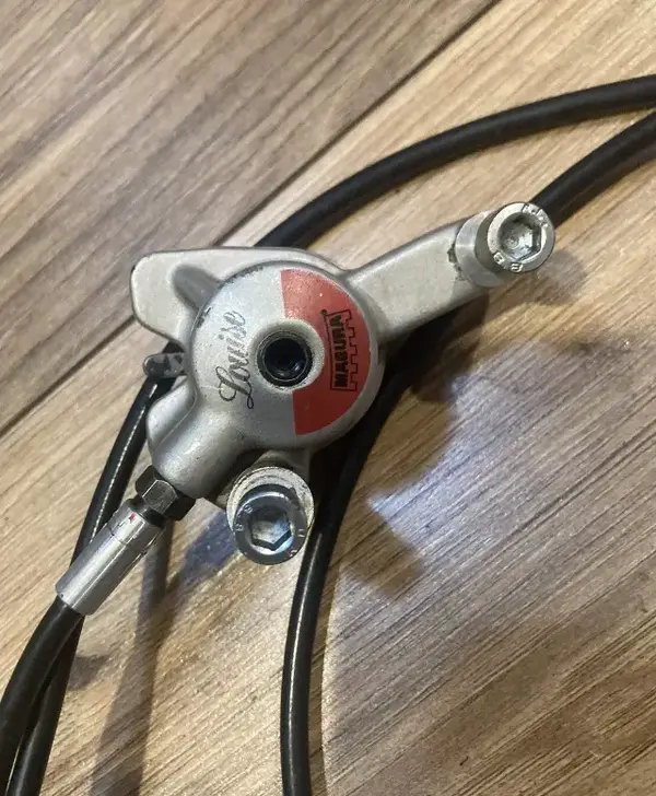

Another quick question though, I have some real old disc brakes (Magura louise - 1st gen 90's model?) and the rear caliper is direct-mount to 50mm IS. The caliper is a bit too fat to fit on my mount and has made me scratch my head a little as to how they were supposed to fit on any other bike. I've attached a photo of how they look, I cant find any pictures of something like this on an actual bike on google.

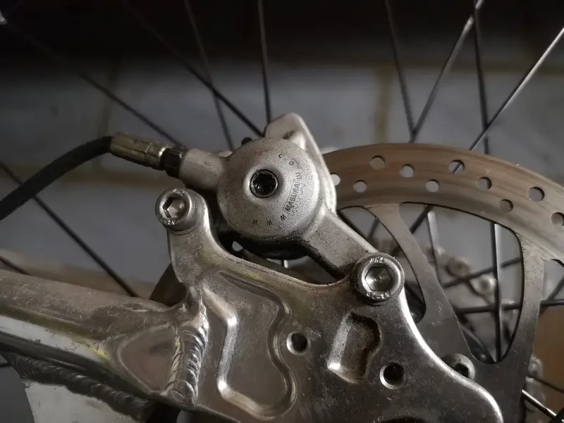

I run the same model Louise brakes on my Saracen. Front and back. Did you get sorted? I can send you some photos if it helps.
I'd like to see pictures of your rear caliper for sure! I've been running them front and back for about 5 months now on my daily and I like them a ton!

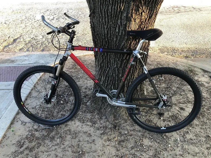

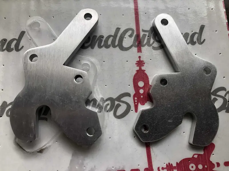

My issue was "fixed" by shaving down the adapter that I got CNC'd for my bike. I felt comfortable doing it as I got it in 7075 aluminum but my assistant making the cut wasn't very patient so it looks a little sloppy 😅. For context, the rear dropouts on the old lugged Cadex CFM line of bikes can removed and replaced. People have uploaded CNC files for ones with disc brake tabs, and got 3 cut for about 30 bucks shipped. Super happy with the bike and it's wonderful to commute to school with!

Here it is. Rear brake on my Saracen, original 160mm Magura rotor too. I think our brakes are identical, except for the red stripe on yours.
Sweet, I wish there was a really good source on some of the older models (or one that I can find) as I had to dig pretty deep to find a user manual for that generation of Louise.
Also, what year/model of bike is that? Googling information on old standards of caliper bracket is pretty hard due to the most of the terminology being interchangeable with the modern standards (IS/post/etc)
