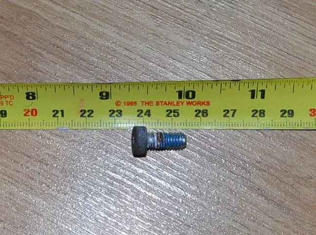

What size are they and how long. I cannot remember?
m5 by 15mm. i would buy socket caps this size from ebay but these ones have shallow heads
*edit: they are m6 not m5, i measured them wrong :facepalm: :lol: all allen head bolts on these forks are m6

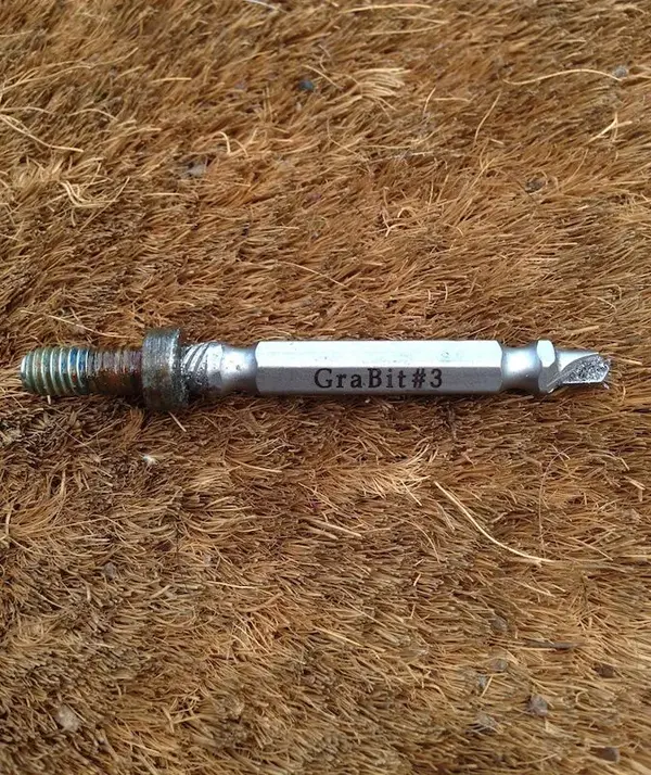

One set of grab it bolt extractors

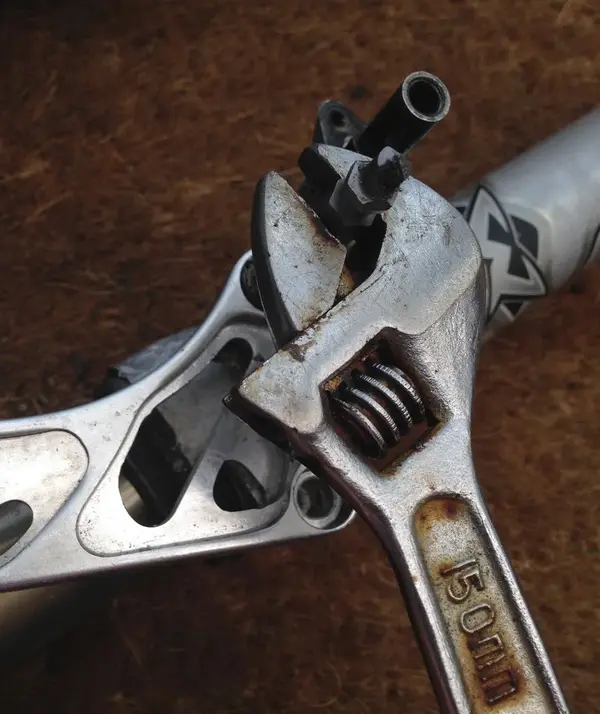

i sprayed WD40 around the outside of the bolt and left it to penetrate down before drilling it to the size of the grabit thread
Typical! the drill isnt strong enough to unscrew the bolt :lol: so out comes the adjustable spanner
Result!

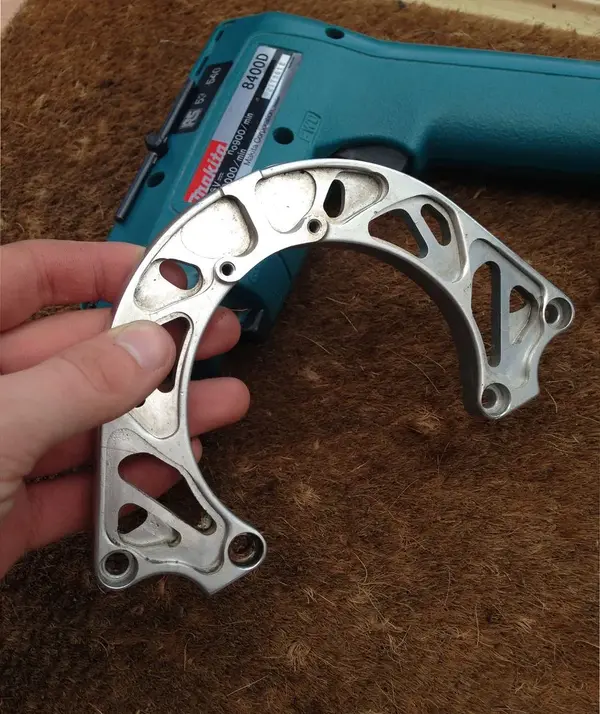

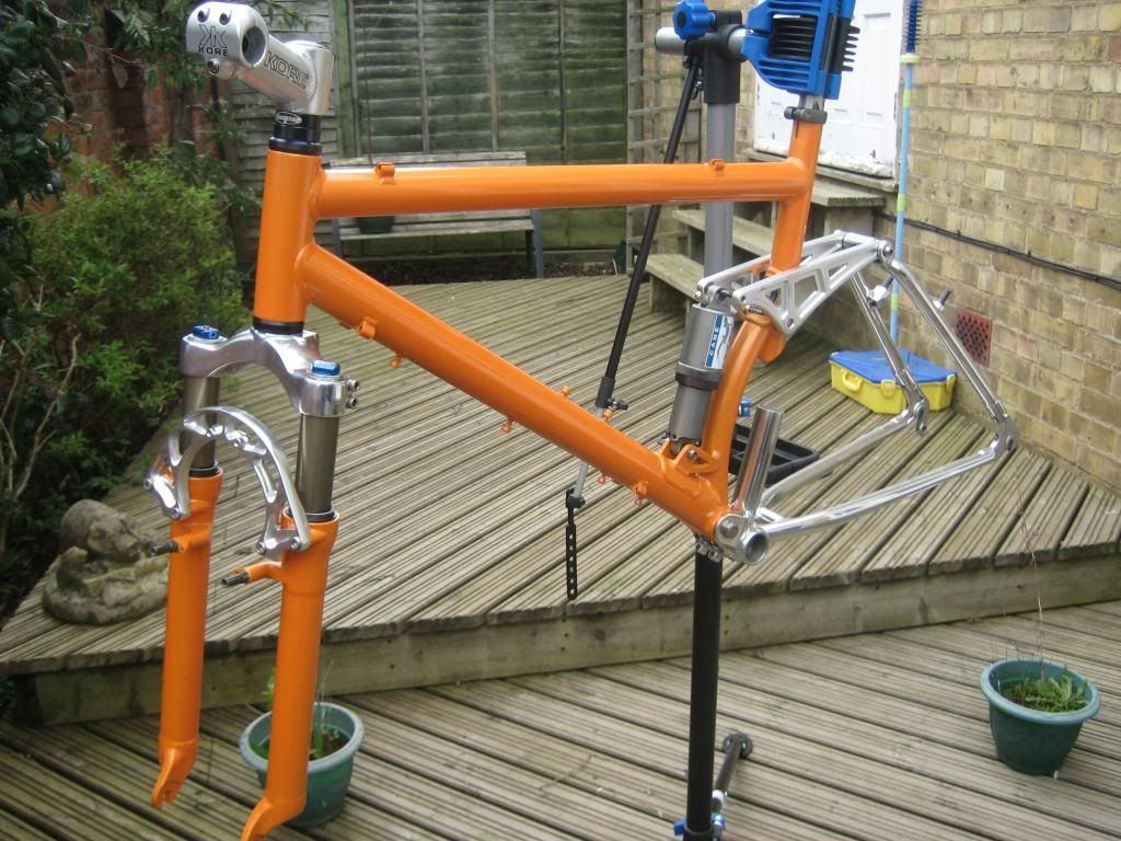

I refurbed my Z2's.
There was someone on ebay selling stainless bolt kits for Marzocchi forks when i did mine, came with them all.
I took the paint off the whole legs with a sanding wheel on my dremmel,took a while but got into all the nooks and crannies :)
I had the lower legs sprayed when my frame was done and they looked amazing.
