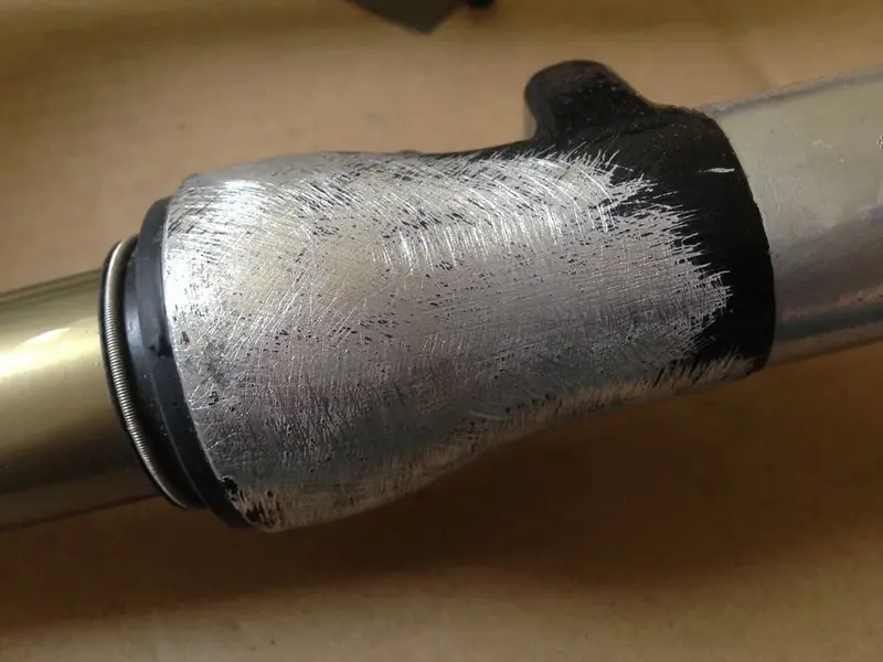

This is the badly scored up surface left behind by the wire drill heads, looks like i got my work cut out :roll:
