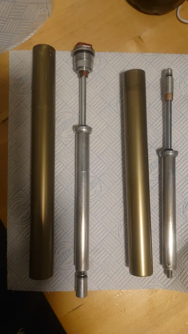

I put them together today.
My plan was to use the stanchions off the Z1s that came on my Arrow DSS-3. This is because the crown on the QR20s had been over tightened by the previous owner, crushing the stanchions slightly making the top caps very tight. Something I know to lookout for now.
This plan had an unexpected issue, the stanchions and damper for the QR20s are bigger than the donor fork. Oh well, plan B it is, I'll just rebuild as is.
Using the original stanchions does pose a problem as the top caps are so tight. How to tighten them as there's nothing to hold on to? Luckily I have a Super T Pro, these have a crown without a lip so can slip onto the stanchions and bolt it up. This gives something to hold and keep the stantions from rotating while the cap is tightened. Unfortunately I didn't photo of this set up. This also means I can't sell the Super Ts as I'll need them to service this fork.

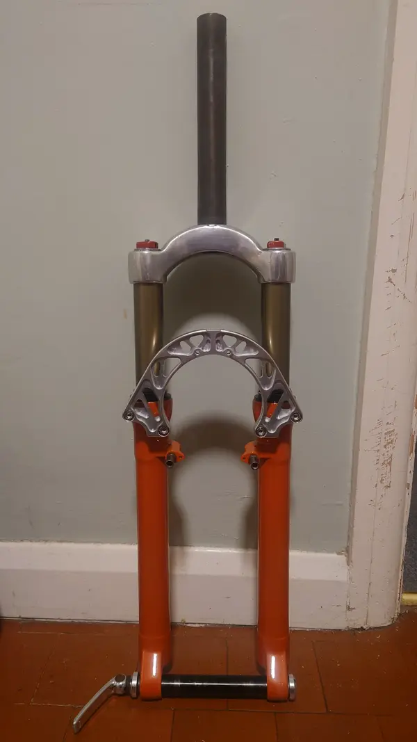

Here they are fully assembled, they look pretty good. Just need the decals to complete.
