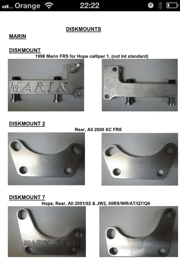

Marin Mount Vision 1998 rear disc mount.
Thanks for the reply.
My information comes from the Marin Uk website support records.
See photo I copied from the website

Have you phoned the UK Marin distributors? They found the replacement swingarm for me when I enquired.
Somebody must know what caliper fits this Marin diskmount
Help please!
I've emailed Marin UK but no reply as yet.

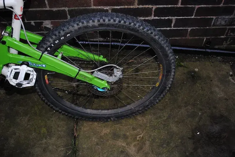

Marin rear disc mount bracket and Hope C2 No 1 caliper
Found the information I needed with this photo.
:xmas-cool:
The question was what caliper goes on that bracket. I researched it and the Marin website said it was the Hope No 1 C2 caliper. I have one of those but couldn't figure out how it goes together. It shows it mounted in the picture. One of the bolt holes that holds the two halves of the caliper together is also utilised as a nounting hole. Together with some spacers this is all I needed. Now looking for a swinging arm with the 10mm threaded lugs before I modify one of mine. :xmas-big-grin:
