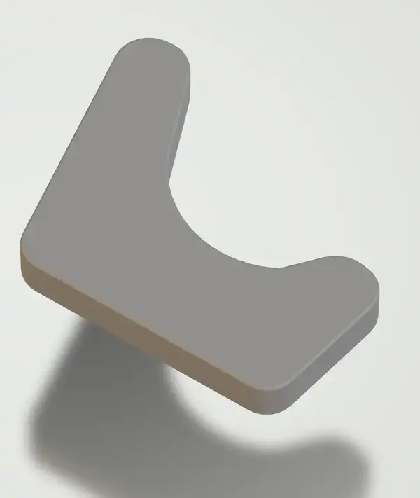

Luckily, I have found someone who is selling the complete frame online. They are providing all the measurements of the bracket to me. I will sketch it up in FreeCAD and create a standard STL file for 3D printing. I can then offer the 3D printed part up, make any final adjustments and create a final STL file to be printed in PETG/Carbon or made from metal
I will also look into creating mounts with integrated adapters for larger disc rotors should the interest take off
I'll keep this page updated

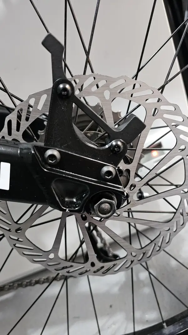

First print is test fitted. The right hand side two bolts need a bit more padding around them as they are close to the edge of the print. I also thing the two top bolts need to come down a touch
I'll print one solid with no bolt holes and mark / drill them out
Height decreased by 5mm and no holes. Padded out thicker (From 5mm thick to 8mm thick) to match the availability for space on the frame
Printing and test fitting in progress...
Completed! 6mm thick was the sweet spot for mounting a Shimano MT200 hydraulic disc brake with no washers as spacers -
It fits and it works. I needed to have the 3D model printed using the hardest PLA that i could (for obvious reasons!)
there is no reason why you couldn't send this 3d model to someone to make out of aluminium/steel if required
This fits a 160mm disc perfectly with no adapters
