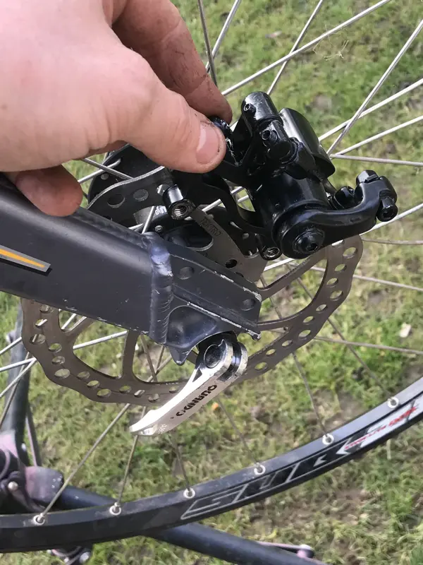

I think i need one of these adaptors for my marin east peak, not sure of the year or exact model. Could you message me details of these

I need one too if anyone knows where I can get hold of one... thanks

Thanks for reply - I saw these advertised, but read somewhere that they didn’t fit - your picture clearly shows otherwise. Many thanks, I’ll get one ordered.

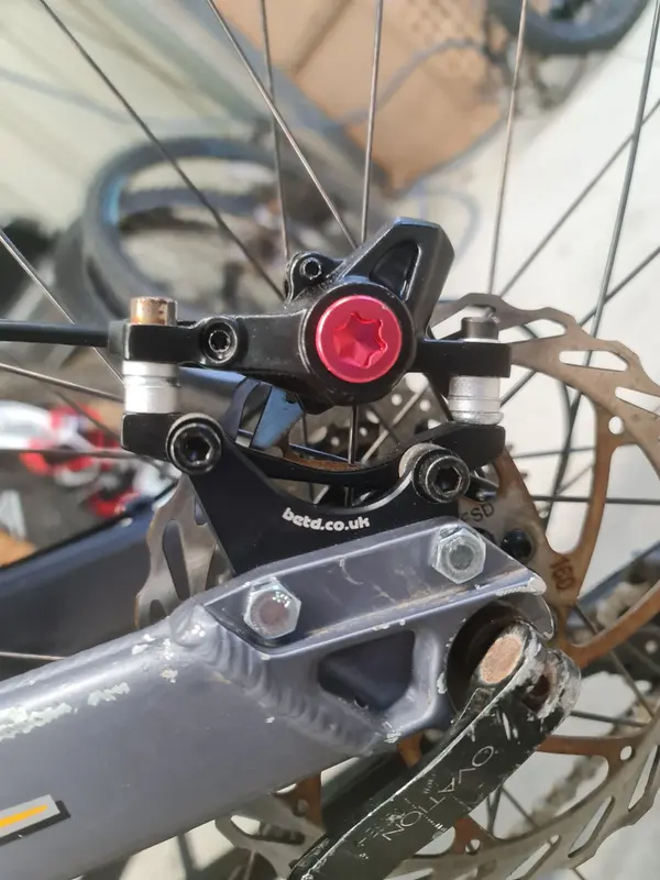

This is where i got mine that someone else suggested in the thread suggested
https://www.mountainbikecomponents.co.u ... c-mount-2/
Depending on size of your discs you may need to pad out a.good bit.
Attached is a temporary setup i have might reduce disc size or get a better spacer set

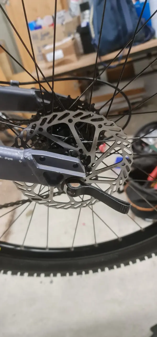

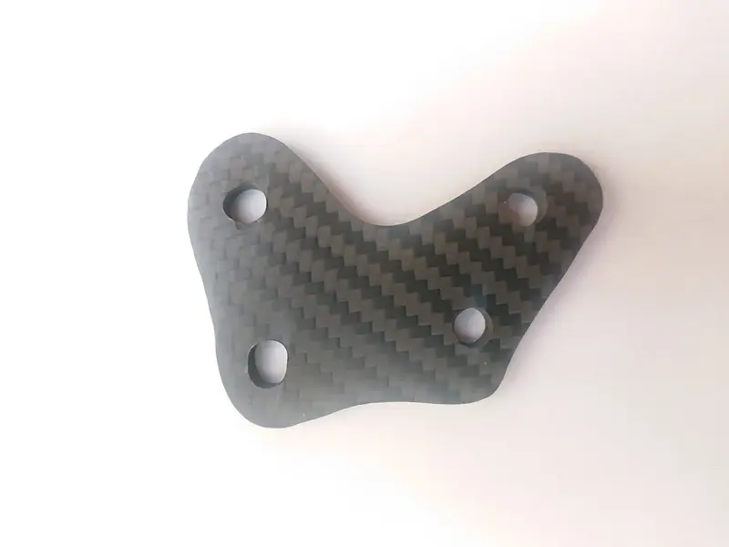

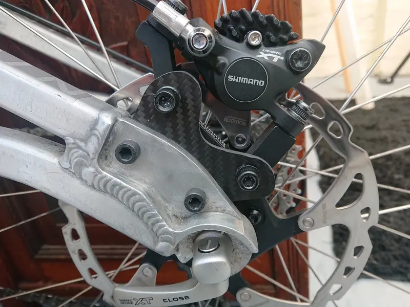

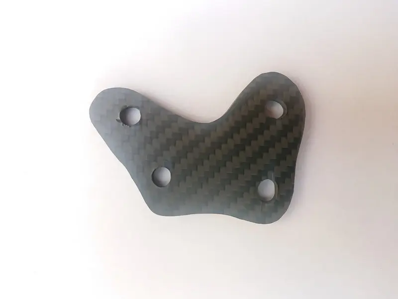

i have made a couple rear disc mounts from 3k 5mm carbon to fit my Marin east peak year 2000 ish so i can run disc brake- see pictures
you can't seem to buy this mount which is why i made my own
its hand made using Dremel so a little rough around the edges, not cnc machine quality but it fits perfect
my set up on bike as i made this mount is as follows
shimano xt m785 disc calliper with shimano xt 180mm rear disc rotor and 180mm shimano is to post mount
if you run a smaller rotor like 160mm then obviously you will use 160mm is to post mount
if you are running different brand of brakes like HOPE i do not know if this will fit, but i would say only shimano to be safe

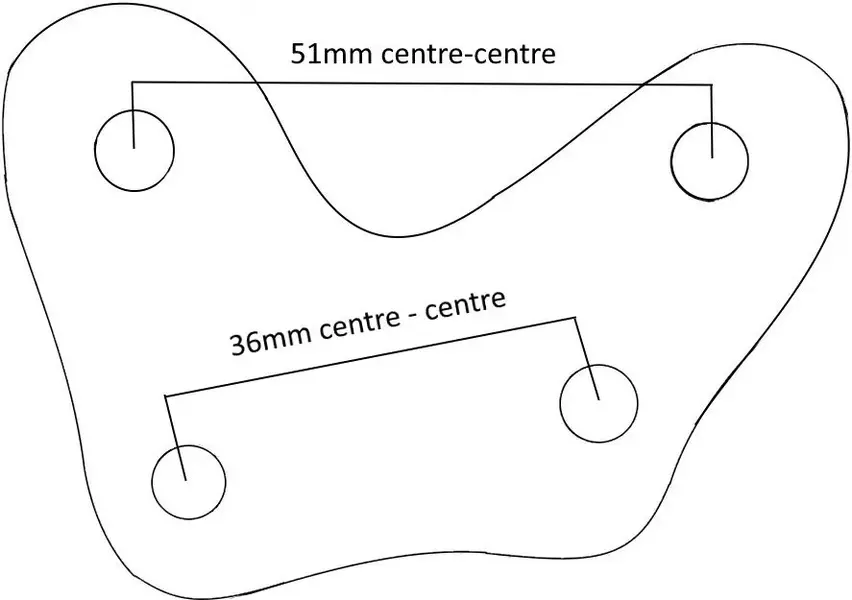

frame bolt holes centre to centre - 36mm
i am selling one spare one if anybody needs one, its here on ebay
https://www.ebay.co.uk/itm/325523280472
