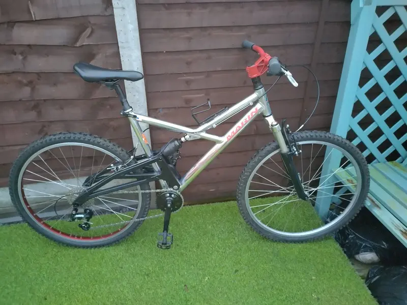

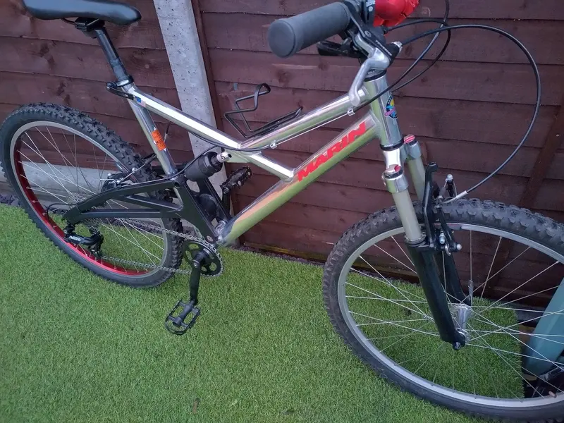

Finally all done,
I stripped and polished the frame then looked at any parts I had lying around so,
RST mozo front forks, OCR comp front rim with Rhino lite rear, Shimano hubs on both. Club roost handlebars with a Marin lite water bottle cage to top it off.
I also changed to a fixed front cog.
It rides really well.

Hi Thanks,
I will get a better pic when the light is better. The shock is what came with it. Get Xmas out of the way and I will be looking to upgrade it. It works well for me at the moment though so may end up spending money on the 93 Eldridge Grade That I have not started yet.

I'd guess 2000, I think they went to monocoque frames in 2001.
They're great bikes, I love my Mount Vision for cross country rides. Personally I think they ride better with an air shock rather than coil, but that's down to personal taste.
