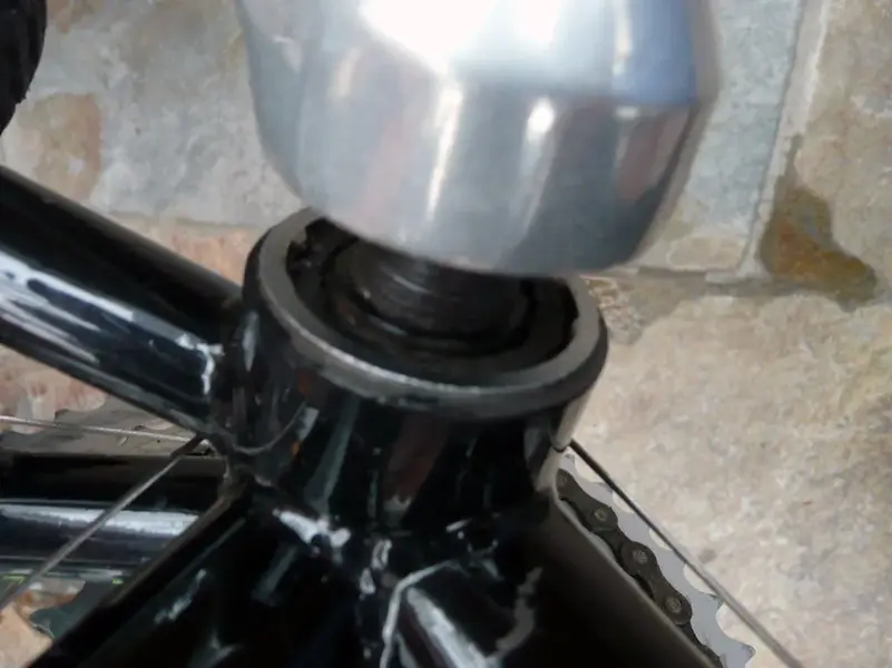

I have freedom of movement in the shocks but with no pressure I dont know if they'll hold or how long they'd last. The BB probably needs a strip downand clean, doesn't move too freely in reverse but goes all the way round and feels smooth with no clunking. There are a few scratches on the frame and most of the chrome bolts have surface rust. Original stickers are abound with minor peal on 1 maybe 2.

Well you'll need a crank extractor to remove the cranks then if not a sealed cartridge BB, a long wide screwdriver to hammer the lock rings and cups out. Not too difficult.
But go to the bike shop get them to do it and buy a sealed BB like a UN52 or similar. So much easier to use look after.

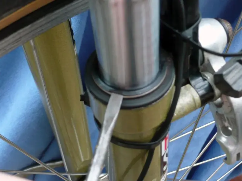

Sorry bit of a typo on my part, the Mags didn't have concertina type boots to cover the chrome, the area with the the problem is the rubber seals at the top of the slider. The rubber is rippling and has connected itself to the loop spring that holds the rubber in place. I'll take some pictures tomorrow in the dark overcast light of day of the BB, Shocks, Seat post QR and overall project view.

If your problems are in reverse that may be the rear mech that's having problems instead of the BB.
Try reverse with the chain off. If not sticking then I'd guess it's most probably a ( easy to fix ) mech problem.

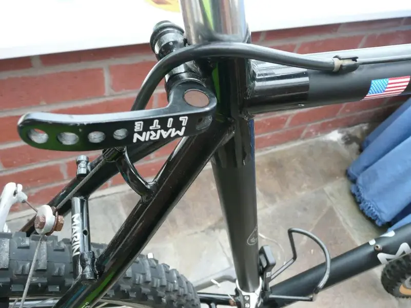

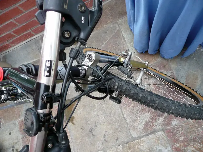

Pics to hopefilly help cure all my ills. Update: went down to a popular sports retail emporium to purchase a hyperdermic adapter, I had a 2.4mm one and the shocks take a 2mm max. Any hoo put about 30psi in each side and presto we have resistance (anyone know what PSI they should have in for the gravy range recommended by Rock Shox?). I've got a feeling that I might have Mag 20's rather than 21's could someone confirm? Here follows the pics:

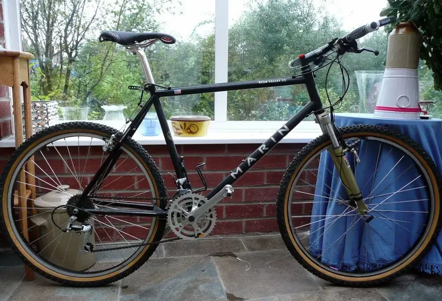

Woohoo! She lives. The spining BB issue turns out to be a dirty chain (Doh!), one clean/degrease later about 2 revs in reverse (good enough for me). Had the jockey wheels/cage to bits, cone/cups to bits, cassette off and lubed everything (used Green oil, not retro is that bad form? Did use some authentic late 80's copperslip for the hubs though) Took her for a test ride jobs a goodun.

Apologies for the modern saddle, grips but I never got on with the originals hopefully still in keeping. I might fit a modern Quill - 1 1/8" adapter for a shorter adjustable stem (the current 120mm on a 19" mid - mid frame is a bit too big for a 5'8" person) unless someone can point me in the direction of a Marin Lite 90-91 stem, about 80mm long?

That is a fine looking machine- lusted after one of those BITD.
Saddle is very important to get right (comfort is king) and I think it does not look to bad, when you are sitting on the thing no-one will see it anyway :wink:
You might be advised to put a request for a swop in the wanted forum to sort out your stem issues or indeed as an alternative- 2 hrs a night on the rack might sort out your arm lenght :lol:
