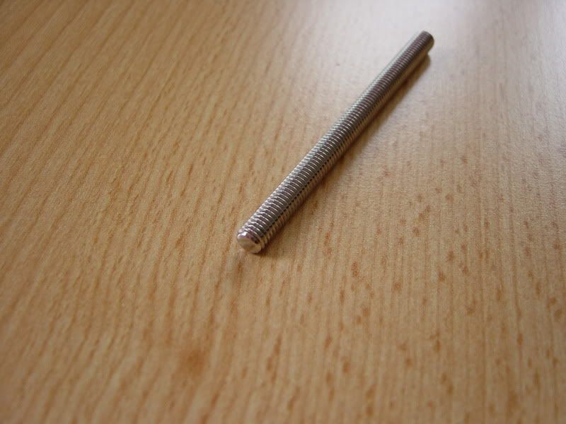

I swapped the angle of dangle screw over for a stainless grub screw that I have rounded the end on - I don't like how the standard one cuts / damages the finish on the dropout, so the standard one was never given the chance ;-)

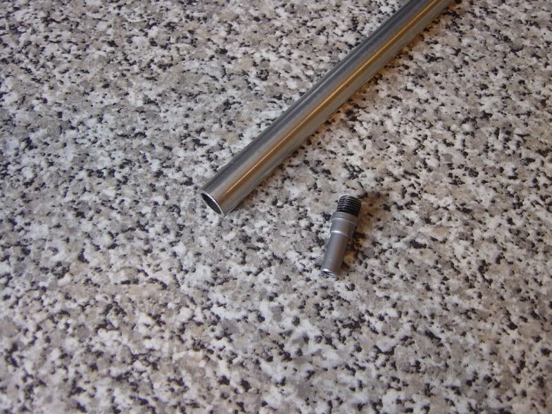

I swapped the plain black seat QR ringle over for the black / polished one and used a washer that broardy made for me, after a bit of a polish (couldn't resist :lol:) :
But as it added a extra 2mm I needed a 2mm longer (Which had to have the ends polished to match the wheel skewers :oops: :lol:) :

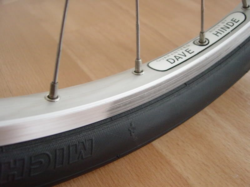

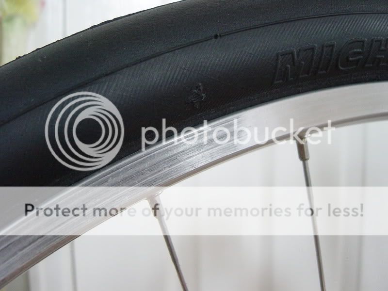

Final job was to clean the braking surfaces. I expected the first few goes at braking to help but it didn't :-( the rims were slightly marked where the bare alloy was - can be clearly seen on here (white patches) :
But the rim cleaning block I bought for the ceramics for the airborne worked wonders :
They look like new now 8)
