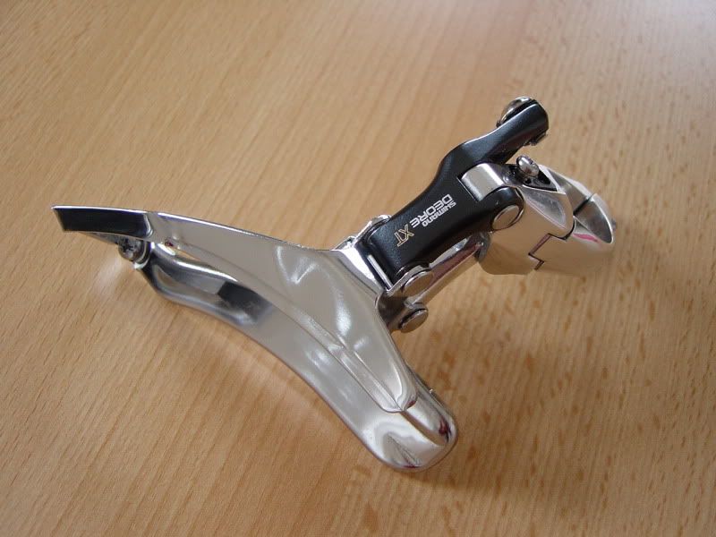

I managed to get it pretty much built last weekend but decided that the front mech wasnt quite up to standard with the rest of the bike :-( shame really as it had been milled out but at least it means I have a nice one to go on the gf's bike :D
NOS and after a bit of polishing to bring up the dulled alloy :
I wanted another 735 as A) it's what it had BITD and B) I was worried about matching the shape of the clamping mark on the seat tube :? As it turned out there was noting to worry about as the lining was unmarked when I removed the old mech :shock:

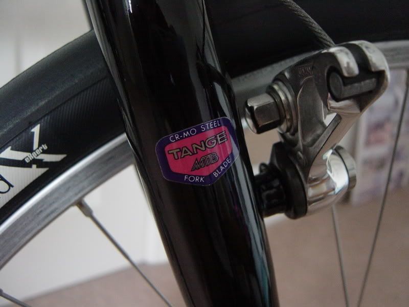

NOS Tange fork stickers I have had from new supplied by Marins importers BITD :
