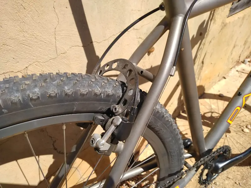

I see. Thanks! Also the paint on some of the parts and adapters is a little tatty. Has anyone sanded down and polished the adapter pieces and slave cylinders? Would they turn out ok (them being cast and not machined)?
polishing might be difficult, especially by hand. I sanded mine and painted them matt black, they came out decent enough (but dusty in this pic but you get the idea)

I thought that too. Painting could be the way forward. I'm afraid that the raw polished cast aluminum parts might corrode easily and end up looking crappy and anodizing is just too much work.
You would not be able to anodize them or powder coat them. The actual piston, spring and seals are permanently fitted into the main body. They would be destroyed by the anodizing or powder coating process.
Careful stripping and spray painting is the only way.
