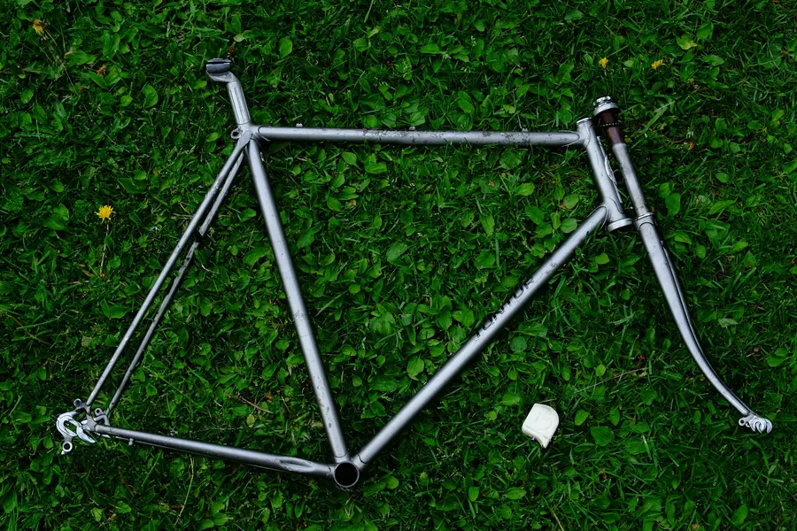

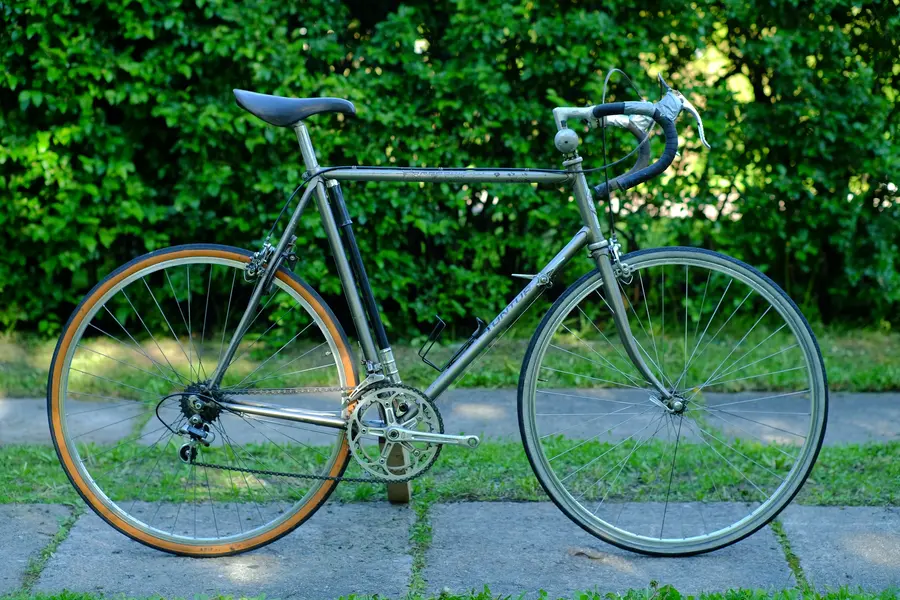

I was gifted this roadworn and well used road/touring bike as the original owner is in his late 80s and doesn't need it anymore.

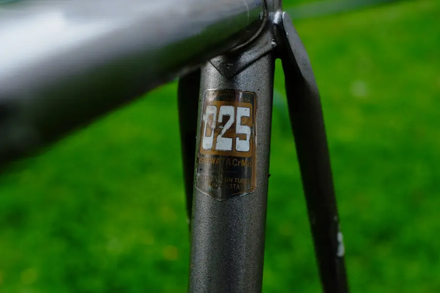

The frame is made with Ishiwata 025 tubing. CrMo main tubes, HT everything else (similar to Columbus Zeta), so hardly a "professional" grade road bike.
Originally these came with a mix of Shimano components. Altus derailleurs and shifters. HS, BB and cranks are 600EX. Wheels with Weinmann concave rims and Shimano 60 hubs.
On this the RD has been swapped to a 105 at some point and for some reason the rear hub has bolt on axle. It should be a qr axle, but maybe it broke. The original Concor saddle and plastic Tunturi frame pump are still on the bike.
Needs a full maintanence, new tires, etc.

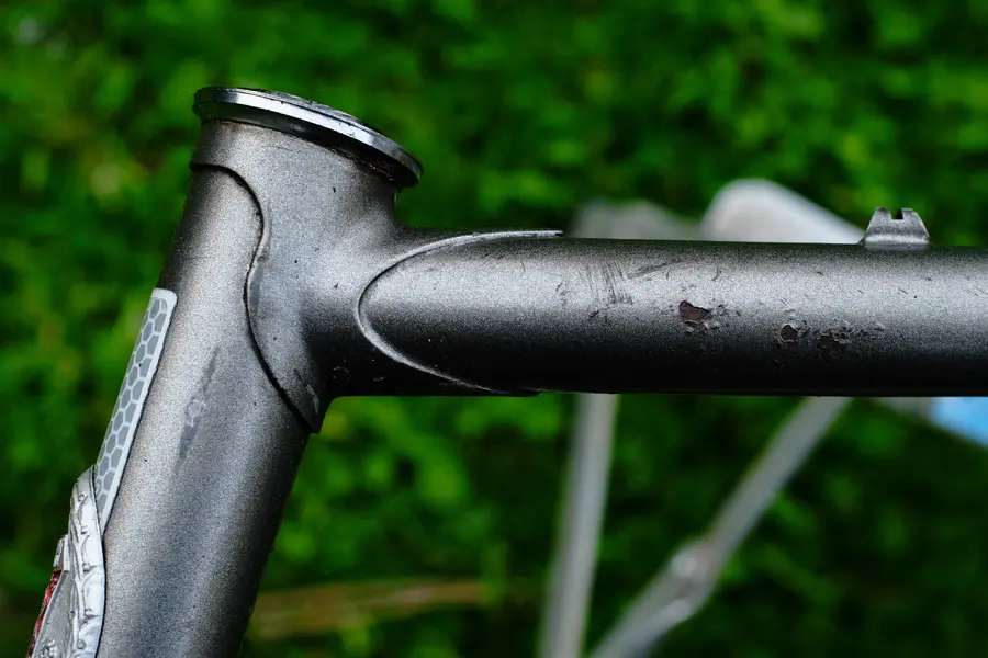

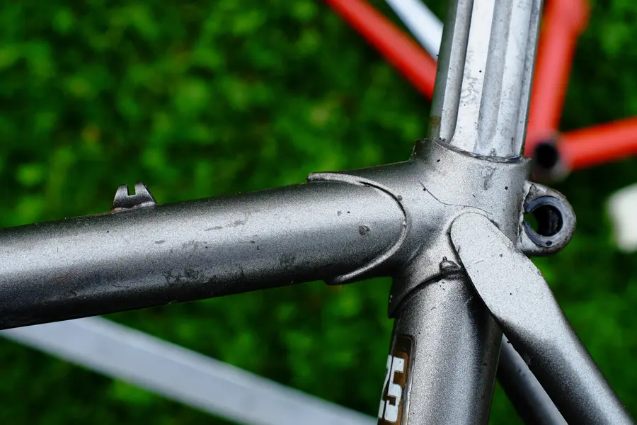

The paint has worn off on both sides of the seatstays above the brake bridge and the top tube has plenty of crusty paint and rust.

The Professional model was first introduced around 1981. The first frames were build in Italy with Columbus Zeta. Probably by Paletti, Piazza and maybe a 3rd. style, made in Switzerland frame. Typical components were Altus/600EX.
A year or so after the frames were build in Japan, possibly by two or more manufacturers (Kuwahara?) and made with Ishiwata 025 or Ishiwata 0245 tubing. Some were sold with the same mix of Altus/600EX components, but from what I've seen some of the ones with the 0245 tubing were fitted with first generation Shimano Deore components.
Also in the early 80s there was an aero frame, maybe made by Kuwahara, fitted with Shimano 600AX.
