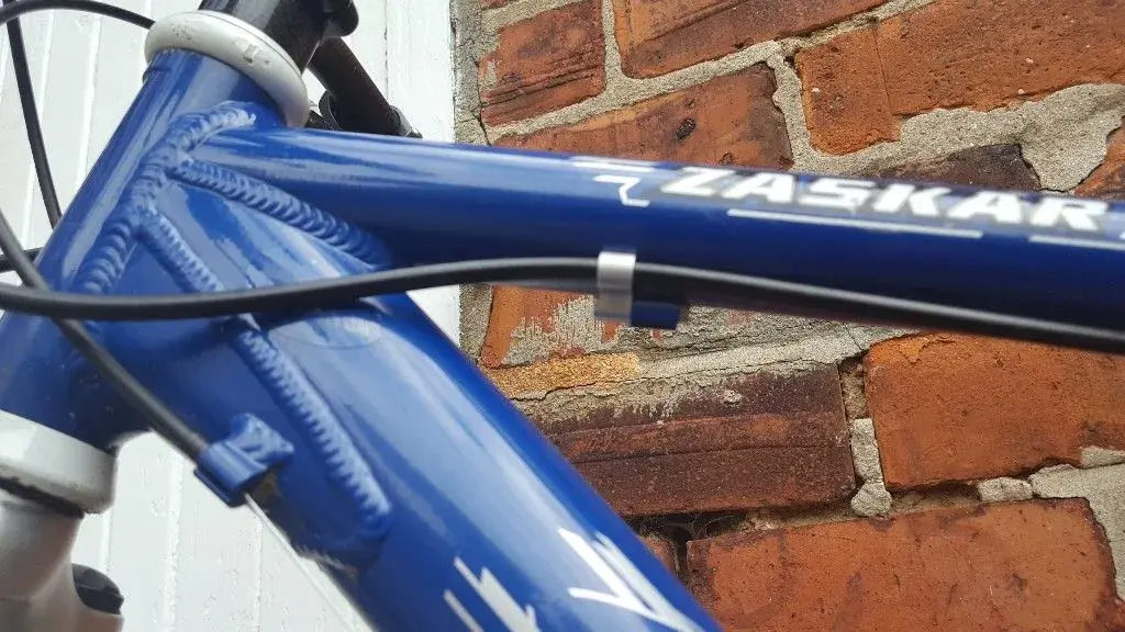

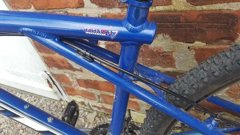

My '98 Zaskar is running a disc rear, but the routing will be similar...

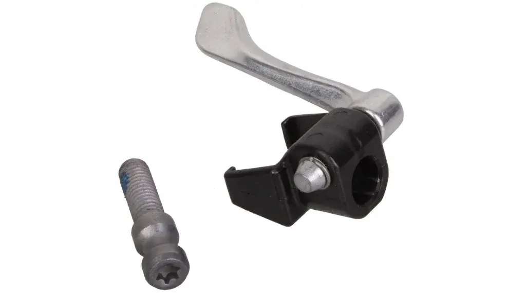

Another advice I want to ask is do you need to deflate the tyres each time you want to remove the wheel with the old HS11s? It will rule me out installing them as I transport the bike with front wheels off.
Probably.
But then there's the Magura quick release thingys for that. :D
If you ask I'm sure someone has spares for postage costs.
Getting the wheel out with the Magura QR it's only slightly more involved than a canti set up but certainly not any more than a few seconds longer.
