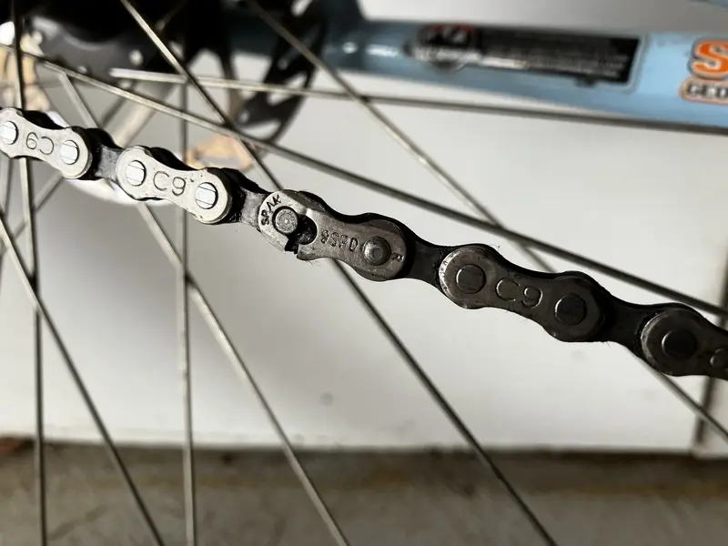

Also with a near silent bike, you notice when things aren't right. Like this... "What's that ticking noise when I pedal..."
Yeah I know... "who runs a SRAM joiner on a SS?" Tight arse single speeders who have been doing this for half their life, that's who. 🤘
