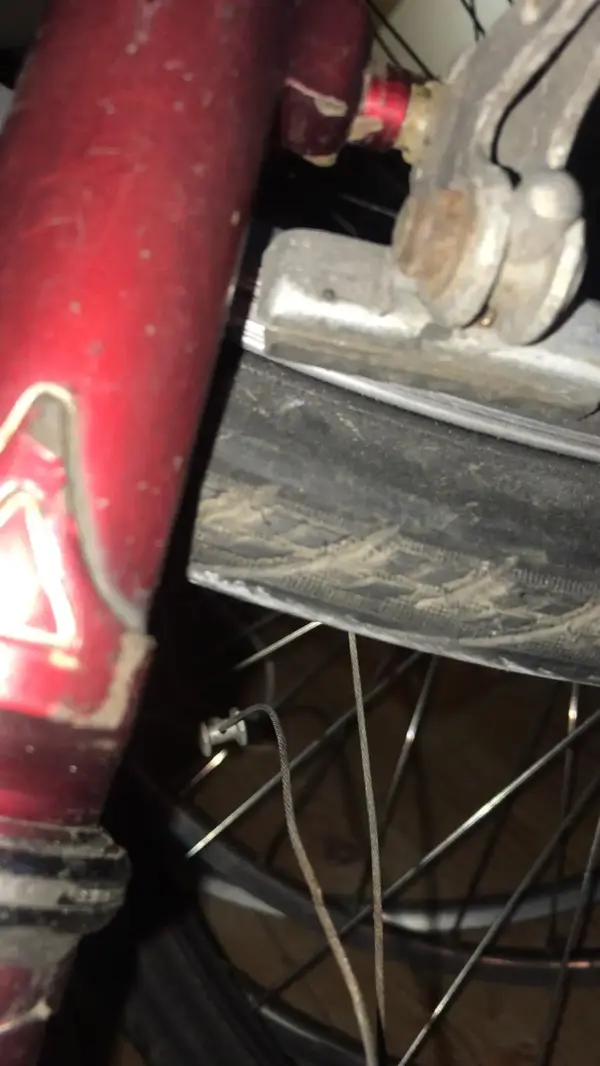

I have a set of vintage cantis came with the flying gate frame in the other thread. Are these worth using with new pads? Or should I replace with newer cantis or calipers which will fit around guards and 28 tyres? I've not run cantis before but I'm not against messing about until they're well set up. So long as it's worth doing!

The problem with mafac, weinmann and frogleg cantis is that there is no up and down movement of the brake blocks. Obviously you can angle them up and down, but if the frame wasn't designed for them, the blocks won't hit the rim squarely.
Ah yes I see. Im hoping they may be original to the bike, late 70s? If they line up are they worth using? Also what pads would be best?
Popped a 700c wheel in to see, looks good to me? Obviously the brakes are wanting a clean up...

I am a big fan of those brakes. I love the minimalist no-nonsense look, and with decent pads they work well. I mostly use original MAFAC pads, but I expect them to work even better with Koolstop replacements.

Whatever you do, don't run Mafac blocks. When I used them dry performance was ok but they were dismal to the point of being near lethal in wet conditions. I understand that Koolstop replacements are considerably better.
