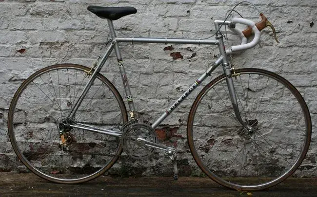

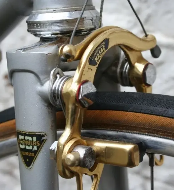

Something in my somewhat faulty memory is suggesting that back in the late 1970s I saw some Peugeot team bikes with Mafac centre pull arms fitted to canti bosses which had been brazed high up the forks and seat stays - rather like direct mount brakes. I haven't been able to find any trace of such on the 'net so maybe they are just part of my imagination.
Don't worry Jim, your not losing the plot, your correct, the PY10 as used by the team from 74 had brazed bosses. The 'Team' bikes were built in the new Peugeot Prestige workshop.
