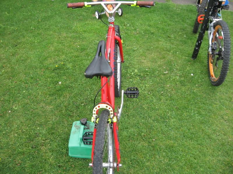

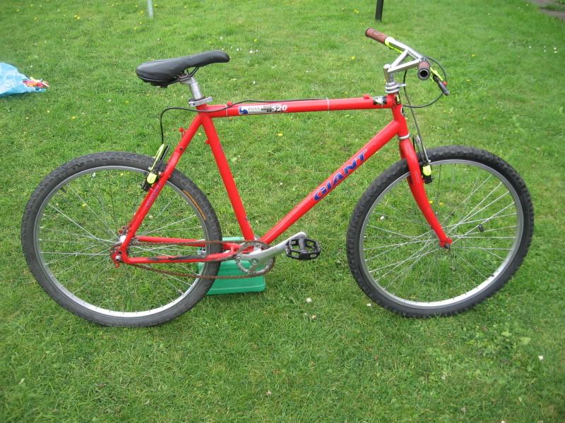

before you see the pictures , yes i know the chains rusty and it needs a tensioner .
it owes me about 50-odd quid but most of thats in the brakes........
pic's lol
now that chain was tight when i put it on :?
Lovin' the bull moose bars!

Looks good Eck just tidy up the drivechain( most important bit as chain slip is very painful ) :shock:

That look's fine Big E 8) , before you buy a tensioner try setting up the chain without, sometimes you can get lucky with the chainstay length and can run a plain chain with no tensioner (look's better), file a flat on the rear axle for a slight tweek, i run my E3 with a normal Shimano chain, 32-16, a new chain on it is very slightly tight but after a few rides when it's bedded in it's perfect.
Big Eck, I like the Giant SS especially the bars 8)

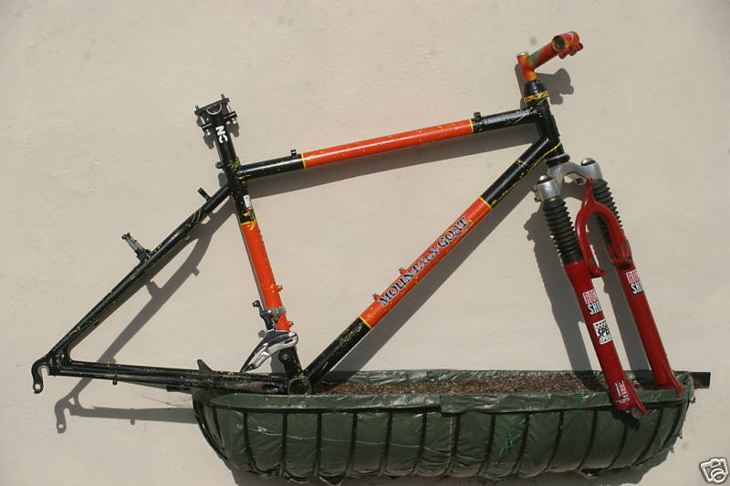

Dr.S cool Mountain Goat, never one for mainstream bikes are you :wink:
