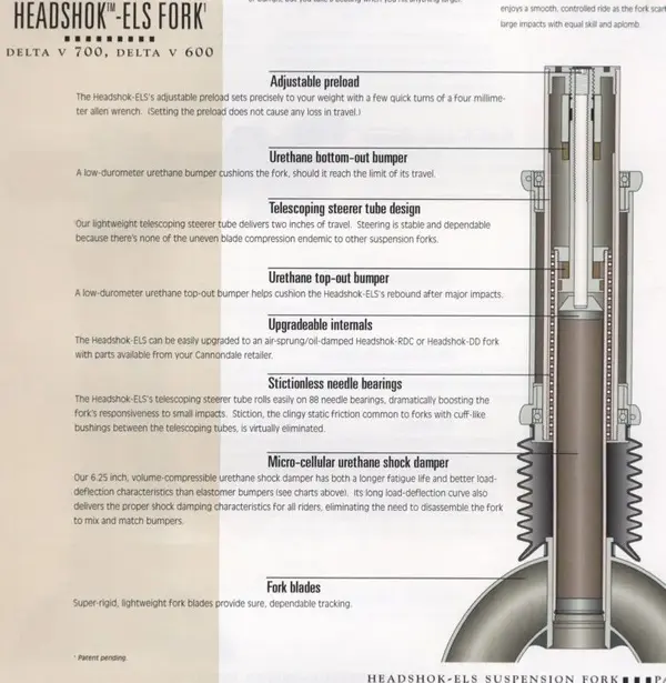

I'd like to take a Cannondale head shock apart to see what's going on in there (old coil/elastomer Headshock I believe).

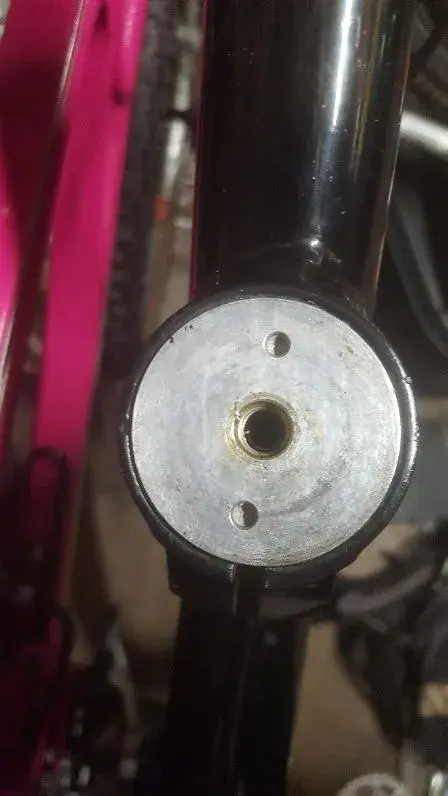

What year and when you take the top cap off what does it look like?
If it’s two pin holes then the tool’s really hard to find. Sold mine with the bike. If it’s four slots then OCP may have a castle tool that will fit.
Don’t be too keen to pull the whole thing apart, if the bearings come out you’re in deep doodoo.
1994 I believe. Its the Headshock ELS, elastomer damped. Think it's just the two holes on the cap underneath, I'll check though.

It works and feels OK in use, but doesn't feel quite as smooth as I'd expect, and there's a slight knocking Eg when going over cobbled Street. Maybe the top out bumper that's the issue.

clubby is correct, don't rush into taking yer Headshok apart. The bearings need to be kept in place as you dismantle it, till you can get it to the stage where you can carefully remove them so that you know where they go on re-assembly. You don't want to mix them up as some of them are different thicknesses.
I also have as he says a couple of castle tools, a 2-part one I bought to remove the damping cartridge from my Titanium Lefty, which it did fine, but didn't fit the earlier Lefty I had too. That required another so-called universal castle tool that was sold as fitting ALL Headshoks and Leftys, it feckin' doesn't. It should be OK to dismantle most Headshoks I have bar maybe one or two. There are almost as many different tools as Headshoks and Leftys, most impossible to get a hold of.
Jim, I bought a knackered Headshok from the Edinburgh Bike Station last year for a tenner as it had good headset cups and bearings. It has Fatty decals but I can't find a Fatty that has a coil spring and elastomer though. You can have it if you want, the elastomer looks OK, but bearings could be completely effed. It would do as spares though. I've a few Headshoks I bought as spares with the intention of rebuilding a couple but never had the bottle to start the job. Having a couple of Leftys on my Cannondales meant there was no incentive either. The thing is though nearly all Headshoks and Leftys can be rebuilt like new by replacing the bearings and the races with new ones which are available if you know what you need/want.
But that all changed when I decided to build up a non-disc F700 frame I've had for years after I found a set of Magura hydraulic rim brakes in good nick in the Perth Bike Station for 8 quid :mrgreen: . So taking apart the effed coil/elastomer Fatty was good practice for doing an actual good disc Headshok that I needed for the F700. The Fatty has the 2 hole cap on top so I could use a Park pin-tool on it. Since I wasn't worried about terminally damaging the Fatty I experimented with a method of holding the bearings and the races in place as I don't have the proper tools. Bogroll tubes..........a couple cut lengthways, slipped over the steerer races with a few elastic bands to hold in place. I also used another couple inside the outer tube part of Headshok to hold the races and bearings together, again cut lengthways, pushed inside each other then into tube with tissue/bit of rag stuffed inside them to jam them in place. I was probably helped in dismantling the 2 parts as the bearings were very stiff and there was no danger they would just easily fall apart like a properly functioning Headshok. I could move it apart taking my time working out the next step. It's still in a box with the bogroll tube bearing/race retaining tools in place. :LOL:

It is the two pin head shock under the cap, I do have a Park Pin spanner (green one I think) so that might get the top end off?
It's just Elastomer on bearings I believe... I'll see if I can fathom it out, probably next weekend, and see what looks like it might be effed...
