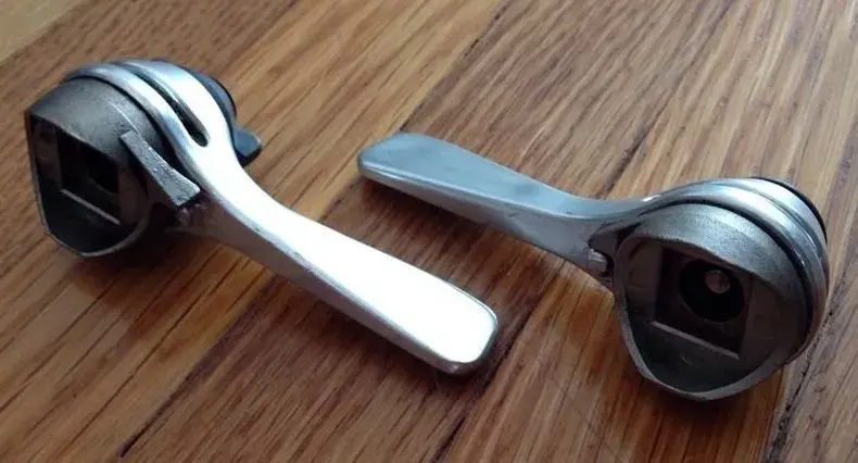

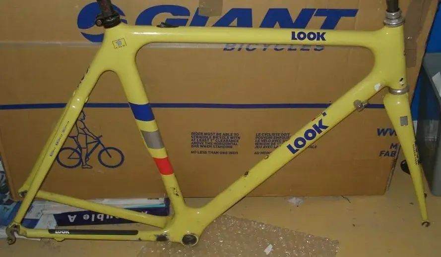

Has anyone got these shifters on this frame ? the shifters have inbuilt bosses for round tubes but that profile is wrong for the "aero" cross section Down tube , should I take to them with a file ?

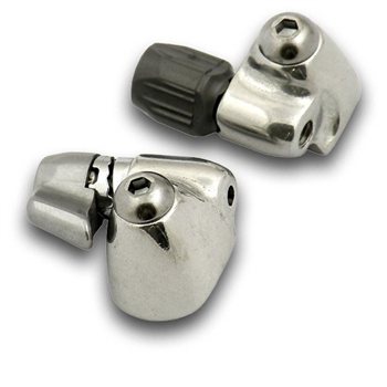

They look like downtube adjusters that are used with brifters, they should unscrew
I have those STI cable stop units in both flat and round iterations and the Looks tube profile is in between both , I have never seen 821s in any other form .
the STI stops are no longer on the frame if that is what you mean
They do look like the round ones with just a bit of filing on the side.
