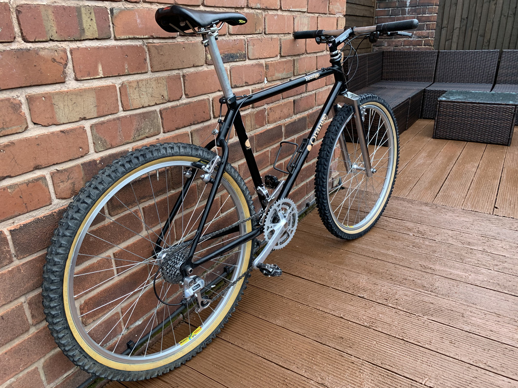

Lockdown build No:3 1992 Orange Prestige ....Finished Update
Re: Lockdown build No:3 1992 Orange Prestige ....
boy"O"boy":24nkdyae said:
clockwork davo":24nkdyae said:
So DX groupset has turned up from France, great nick but the STI’s have the distinct aroma of cat piss :!: very random :shock:
Moving along nicely I still need a DX front mech that was missing from the group so if anybody has a 28.6 bottom pull knocking around also hunting for a set of Hot Rod bars but at this point I’d take any nice polished ally bars !! :facepalm:
Also pondering on a polished stem maybe a syncros if one can be found without having to sell the kids to fund :wink:
This is the first bike with a non-black groupset and polished bits I’ve built and I actually quite like all the polished metal finally get the attraction :roll:
Another great looking build. 8)
Personally, I'd lose the 'stalk' and either try an earlier one or do a black Syncros/Control tech. It looks too 'new' if you know what I mean.
Is it a genuine 'stalk' or a rebadged something else?
Everything else is spot-on once again.
I've got the DX mech you need. I'll send you a PM.
No hot - rod bars though :(
Cheers.
boy"O"boy
Agree on the stem, I’ve got the feelers out
reading with interest as just picked up a small one of these from here that was intended as a cheap runaround for my daughter, but now bit more inspired. Serial number on mine is A207 so July vs May. Curious that yours had a Shimano 600 headset but not original ? as mine had the same by the look of it ?
Re: 1992 Prestige
Interesting deffo a Ritchey Logic mines a 92 same month a few numbers on.
Mines black came from Stif Leeds with Pace.
Decals must have been added at shop often differ yours has the Orange with inset Prestige on seat tube.
Re: 1992 Prestige
Have you got a pic for comparison?
Re: Pic
[img
Cool
I’m sure it must have depended on what day of the week it was as to where the decals ended up !! Monday to Thursday consistent! Friday anywhere will do let’s go the pub !! :roll: :lol:

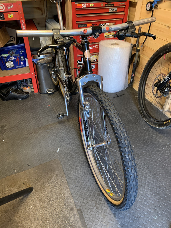

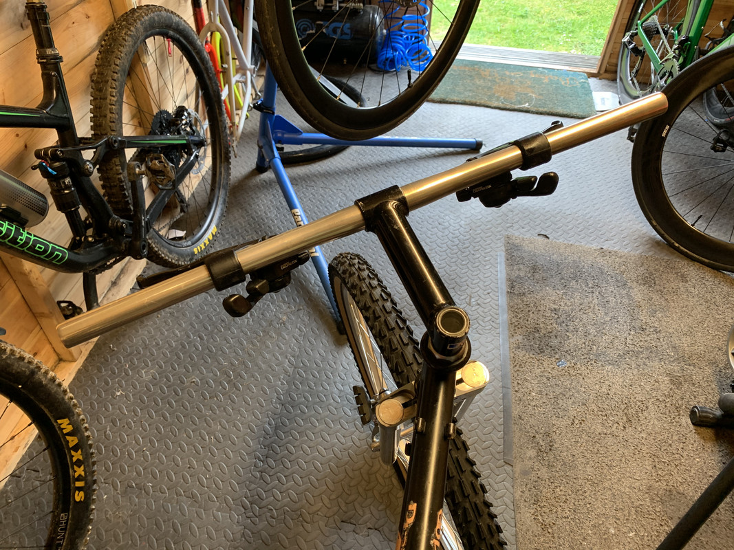

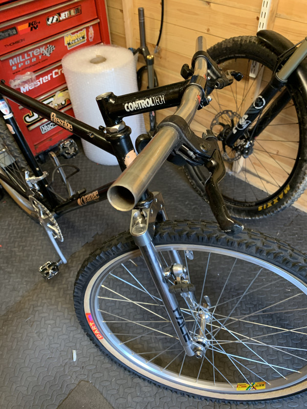

Couple of parts have arrived so have thrown them on!
Still on the hunt for a syncros cattleprod but until then controltech will handle stem duties
Picked up some hot rods with really good decals still, and some rc130’s so will play around and see which pair float my boat the most :lol:
And rolling with some STI’s
Is it just the camera angle or are those bars wider than usual hot rods?

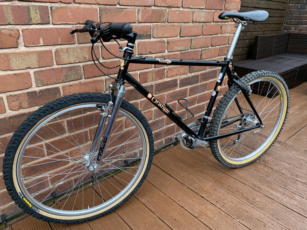

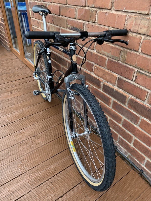

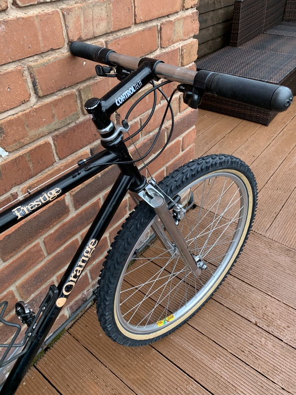

So the Ugly ducking is finally finish
I was pretty Meh about this bike when it turned up but know I love it
Frame: 1992 19” Orange Prestige (Ritchey tubed)
Fork: Pace RC30 Mk2
Headset: Deore DX
Stem: Controltech quill
Handlebar: Pace RC130 Silver
Grips: ODI Attack
Brakes: Shimano Deore DX BR-M650
Brake Levers/shifters: Shimano Deore DX ST-M071 STI
Front Derailleur: Shimano Deore DX M650 28.6
Rear Derailleur: Shimano Deore DX RD-M650
Cassette: Shimano HG
Chain: Shimano HG
Cranks: Shimano Deore MT60 Chainset 175mm
Chainrings: SG-X
Bottom Bracket: UN55
Pedals: Shimano SPD Pedals PD-M525
Hub Skewers: Deore DX SQ-M650
Rims: Mavic M231
Hubs: Shimano Deore DX hub FH-M650 HB-M650
Tyres: Panaracer Smoke and Dart
Saddle: Flite Ti
Seatpost: Kalloy Mirco adjust
